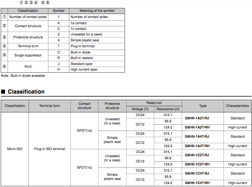

docc Posted January 14, 2017 Posted January 14, 2017 As many of you know, I am a fan of the OMRON relays for the V11. I found Ryland3210's evaluation compelling and have seen numerous (other) relay failures on V11 over the years. Yet, I'm afraid I keep posting a Digikey link for an part no longer available through them. I struggle with deciphering this part number: G8HN-1C2T-R DC12 --->EDIT (Mar 28 2018): Best (High Current) Relay, derived from this thread: Link to this post on page 5:http://www.v11lemans.com/forums/index.php?showtopic=19755&p=216605 2

Kiwi_Roy Posted January 14, 2017 Posted January 14, 2017 I wouldn't worry about being sealed, they are upside down under the seat The C in the part No is for form C normally open normally closed (5-pin) I think R is for resistor across the coil, 12 for 12 Volt coil I suspect the Panasonic will be good quality also
docc Posted January 14, 2017 Author Posted January 14, 2017 I see the spec sheet offers the code breaker and the "2" indicates non-sealed. Form A is 4-pin, and Form C is 5-pin (SPDT) http://www.omron.com/ecb/products/pdf/en-g8hn.pdf 1
docc Posted January 14, 2017 Author Posted January 14, 2017 My beloved GH8N OMRON relays appear to have come NLA. The spec sheet for the Panasonic states they are silver alloy contacts rated 10amps NC / 20amps NO for continuous current. So, that appears to be better contact material than the GEI. Doesn't Relay 5 operate continuously Normally Closed for the fuel pump, coils and injectors? [Answer: negative. ] ______________________________________________________________________________________ edit/ Correction : (thanks, Kiwi_Roy!): Relay#5 (Fuel Injection/pump) operates through the NO (Normally Open) contacts carrying some 22.5 amps.
Kiwi_Roy Posted January 14, 2017 Posted January 14, 2017 Relay 5 is normally Open it's the state at rest (no power) they refer to. Sent from my shoe phone! 1
