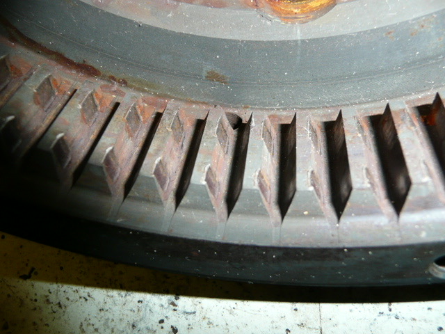

Chuck Posted January 20, 2017 Posted January 20, 2017 Here's my experience with lubes on the splines. To make a long story short, I tore a strada down shortly after putting it back together chasing a mystery vibration. Now, every Guzzi I've had apart has had rusty splines, so on the advice of Wayne Orwig, I made up a slurry of chain lube and moly and applied it to the splines with an acid brush. Obviously, you don't want to put so much on there that it gets flung onto the clutch plates. After putting it back together, the mystery vibration was still there, so Itore it down again for a complete balance of the rotating assembly. Less than 1000 miles, and there was no sign whatsoever of the lube I'd put on. Need I say that I don't bother anymore? Now, about that clutch plate thing. Because of the uneven firing order (270/450) she soundsa good.. but when the springs are compressed the clutch plates and intermediate plate are free to rattle back and forth on the flywheel and transmission input splines. This will eventually wear grooves in both sets of splines. The first sign the rider sees is a clutch that suddenly engages.Once that happens, there's no option but to replace stuff. Those splines will last forever unless you hold the clutch lever in for extended periods. Oh, the mystery vibration? Sometime in it's life, it had been down on the right side and bent the crash bar enough to cause a sympathetic "singing" for want of a better description. D'oh!

pete roper Posted January 20, 2017 Posted January 20, 2017 I don't kmow how I wrecked my edit but I will try again . You will need to disassemble this and apply lube to all splined areas . FIRST you must remove all rust and clean the areas because rust is a great abrasive . I would apply lube to the release fingers and clean and lubricate the release bearing with a good disc brake wheel bearing grease . Only the Guzzi system doesn't use an automotive type release bearing and yoke. The release bearing is at the back of the gearbox nd is acted on by the piston of the slave cylinder directly. On the subject of lubricating the splines? I'm with Chuck nowadays. I see lubricating them as pointless and if too much slippery is applied actually counter productive. On the subject of the noise? I haven't been able to view the video but looking at the flywheel I'd say it's been the victim of three things. 1.) What Chuck described. 2.) Poor throttle body balance. 3.) Too low an idle speed. If your idle speed is low and the TB balance is off the rocking couple caused by the uneven firing intervals will be greatly exacerbated. Any 'Knock' will most likely be the primaries in the gearbox flogging to and fro as the input shaft accelerates and decelerates with the crank. Give it a tune up and get the idle speed up to a minimum of 1100rpm. See if that fixes it. 1

MartyNZ Posted February 19, 2017 Posted February 19, 2017 ...flywheel, I will probably replace with a beautiful Ergal aluminum flywheel. Price about 500 euros... That flywheel looks like a work of art alright, but I worry that you may be disappointed if you fit it. Aluminum is not durable as a flywheel material. It would be great for racing, where frequent inspections and rebuilds occur, but it cannot last as long as a steel part. There are some reasons why aluminum is not used in most flywheel designs. Aluminium is weaker than steel and softer than cast iron. There are some very strong aluminum alloys, but these are susceptible to corrosion and stress corrosion cracking, so need surface protection and frequent inspection. Alum does not have a fatigue limit like steel, so it will eventually crack from the constant load reversals from the engine compression/power strokes from those two cylinders. The surface of alum can be made hard enough for wear resistance in the contact faces of the clutch rotor teeth by hard anodising, but still wear in those teeth will exceed that of the factory flywheel. The inertia is important too. An alum flywheel has less rotational inertia, unless the manufacturer does something clever with a thicker rim. If there is less inertia, then the torsional vibrations through the drive train will be greater (worse for your gear backlash). I don't want to be a downer, but you should be aware of these things before spending money on an aftermarket product. The factory flywheel & clutch is a well optimised design, if you ride on the street, and value durability, tractability, and cost.
