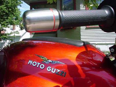

al_roethlisberger Posted February 1, 2004 Posted February 1, 2004 Here are the two forum threads specifically on "Throttlemeister" returned via the Search function: http://www.v11lemans.com/forums/index.php?...throttlemeister http://www.v11lemans.com/forums/index.php?...throttlemeister The first thread was when I first contacted the Throttlemeister folks back in Summer 2002 right after buying the bike, and they didn't have a specific fit for the Sport/LeMans but supplied me with a universal fit for the correct bar diameter. I believe they have a more specific unit for the Sport/LeMans now. I can't recommend the unit enough, top notch workmanship Excellent throttle "lock" and great looking and heavy bar-ends, all in one package, with a nice Italian red stripe to boot The photo below shows their "heavy" unit installed, and although the "heavy" model is long, the photo's perspective exaggerates the effect unfortunately. In real life, the "heavy" units are a great fit for the bike. You can see photos of them installed on my bike at: Al's Throttlemeister Gallery al

al_roethlisberger Posted February 2, 2004 Posted February 2, 2004 ....that's interesting, as I couldn't get a Vista-cruise to work on the LeMans I've heard good things about the VC, but for me the TM was a great combination of throttle-lock AND extra-heavy bar ends al
