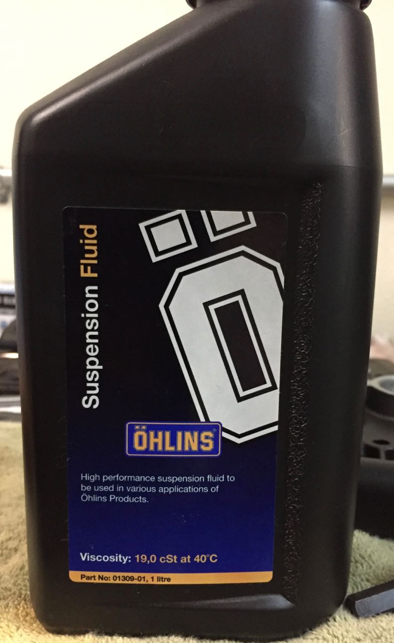

Chuck Posted February 8, 2017 Author Posted February 8, 2017 I hate to be so needy, but I *have* searched here to no avail. The local Ducati dealer has the seals. Which fork oil should I get? 1309?
Scud Posted February 8, 2017 Posted February 8, 2017 Just get the Ohlins fluid. It says part number 1309-01.
Chuck Posted February 8, 2017 Author Posted February 8, 2017 Just get the Ohlins fluid. It says part number 1309-01. IMG_5804.jpg Ok, thanks again. I'm surprised at the lack of info on this site. Probably everyone already knows how to do it, but I'm going to do a blind leading the blind thread. This way, if I'm screwing up, somebody will save me, and everybody will learn. 1
Scud Posted February 9, 2017 Posted February 9, 2017 Just get the Ohlins fluid. It says part number 1309-01. IMG_5804.jpg Ok, thanks again. I'm surprised at the lack of info on this site. Probably everyone already knows how to do it, but I'm going to do a blind leading the blind thread. This way, if I'm screwing up, somebody will save me, and everybody will learn. Cool - I watched some youtube videos on rebuilding Ohlins forks. I know there are some good threads here on doing the Marzocchis. I was thinking about doing my own rebuild - I called Dan Kyle and said "Sell me everything I need to rebuild my forks." That's how I got the seals and oil (and special tool). But I ended up just taking the forks and supplies to an Ohlins specialist at Moto Forza (local Ducati dealer). Next time, I'll follow your instructions.
Chuck Posted February 9, 2017 Author Posted February 9, 2017 Alrighty, let's dive into this. Here's the patient, nervously awaiting surgery.. 2017-02-09_05-00-03 by Charles Stottlemyer, on Flickr The local Duck dealer had the seals.. 5 bux cheaper (Guzzi content) than Dan Kyle, and no shipping. Ohlins is *really* proud of their fork oil, however. 30 bux a liter? At any rate, knowing full well that fork oil does not = fork oil.. some manufacturers 5 wt. might equal another's 10, etc. I coughed and paid. 2017-02-09_05-00-35 by Charles Stottlemyer, on Flickr The adjustable pin spanner is for my angle grinder. It fits, but may be too wimpy to do the job. My pup, Tylon, has the cnc mill tied up for a while, though, so if I have to make one, it'll be the hard way with layout, drill press, and band saw. Yuck. I *did* make a fork leg holder that way out of some engineering plastic, but that went pretty fast. 2017-02-09_04-57-04 by Charles Stottlemyer, on Flickr Hopefully, the pin spanner will work and we'll get into those fork legs tomorrow. Stay tuned. 1
