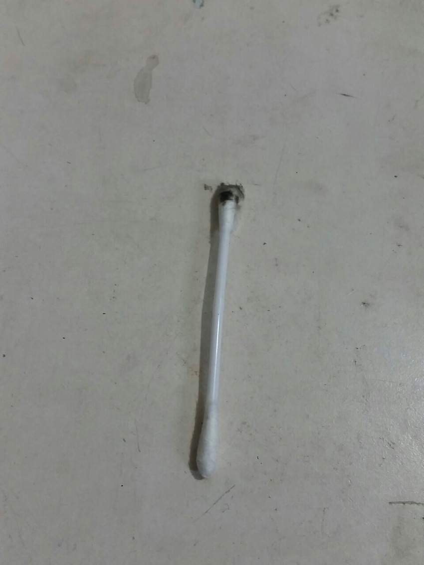

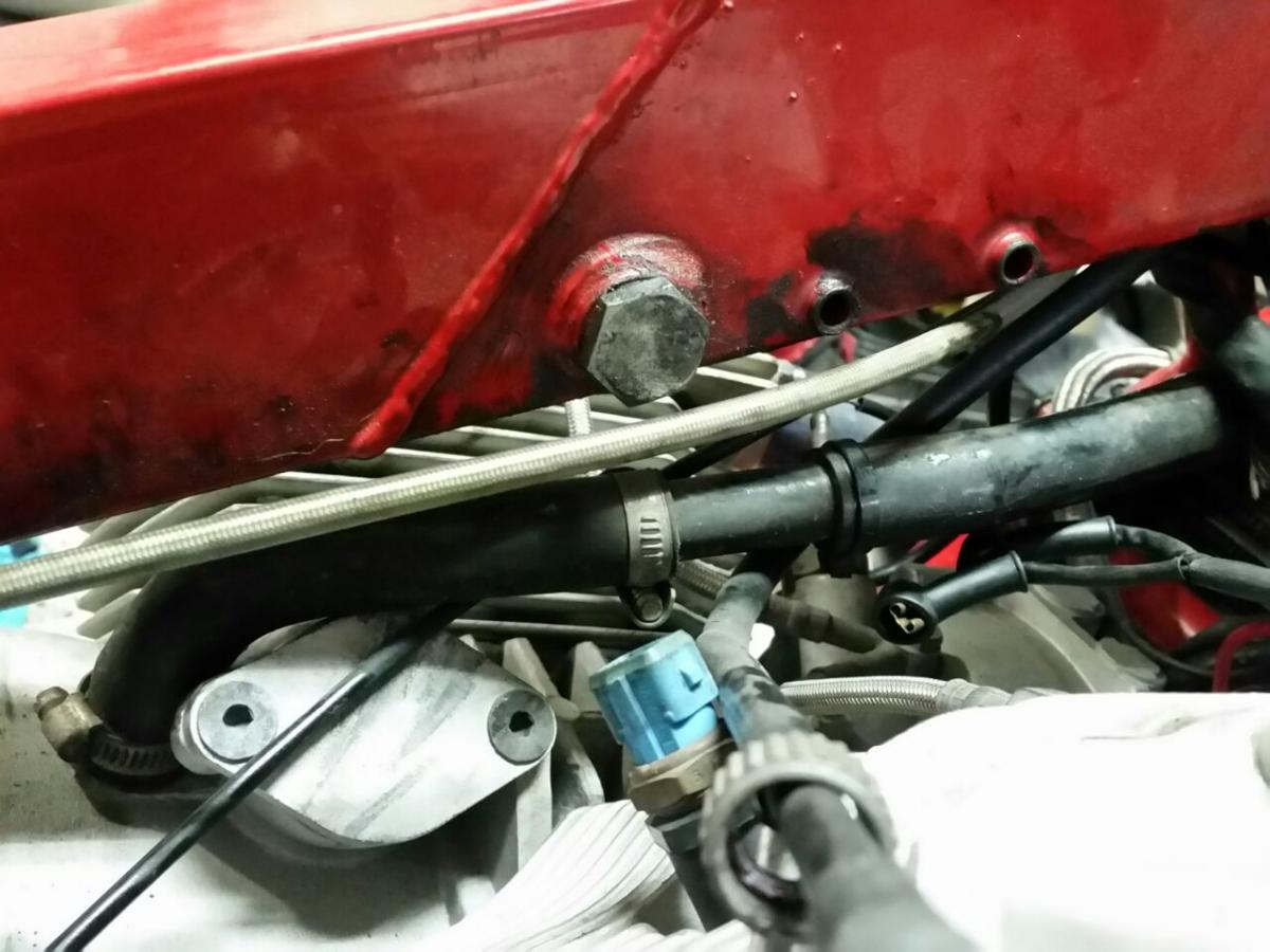

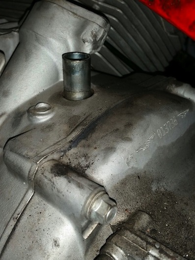

Midle Age Warrior Posted February 13, 2017 Author Share Posted February 13, 2017 If you have not yet cleaned the engine, you could run a cotton swab between the metal tube and the case - go all around the outside of the tube inside the case. If it comes back oily, you know the hose was problem. If it comes back dry - that might be inconclusive if it's been sitting for a while. Scud my californian brother from another mother... I am not sure if I understood how the breathers work but I took the cotton swap and rubbed the inside of the tube that comes from the bell housing and got this I found the out side of the tube is dry and clean after took the hose out What do you think Link to comment Share on other sites More sharing options...
Midle Age Warrior Posted February 13, 2017 Author Share Posted February 13, 2017 You've got it this far apart, and if there appears to be no leakage from the breather tube into the bell housing from the external hose and fitting you may as well pull the gearbox off and take a look at the breather fitting and engine rear seal and gearbox input shaft seal. Ciao Lucky Phil, at this point I could do that and see what is inside the belly of the monster and fix whatever is need it, but do I need special tools to do that? I read in the archives about to take care of the rear swing arm off set before disassembly. Any input about it? Thanks in advance Link to comment Share on other sites More sharing options...

Scud Posted February 13, 2017 Share Posted February 13, 2017 It does look like a puzzle. Since you're so far in, you could remove the engine and transmission and give everything a good inspection. That looks like a lot of old oil behind the right cylinder. If it's leaking out of the base gaskets, you might need to re-torque the cylinder heads. It's least likely to be something major like a rear main seal. And more likely to be something simple that you will discover as you go through it. On the swingarm alignment... we were just discussing that on another thread. I have offered a contrarian opinion. All the same, you may as well measure it before you take it out. You're so far in that you should at least inspect the swingarm bearings - and replace if needed. And pop the driveshaft off and give it thorough clean and lube. You'll just have to ride the BMW for a while... Link to comment Share on other sites More sharing options...

docc Posted February 13, 2017 Share Posted February 13, 2017 So, yes, the breather hose can leak down through the "bell housing" without much spill on the outside. http://www.v11lemans.com/forums/index.php?showtopic=18243&hl=bell%20housing%20oil%20weep%20hole&page=1 There are several likely sources beyond the rear engine main seal. Here is Pete Roper's (colorful) take on the matter: http://www.v11lemans.com/forums/index.php?showtopic=3751&p=35372 Look, also, at the vestigial distributor blanking plate that uses an O-ring to seal. Link to comment Share on other sites More sharing options...
