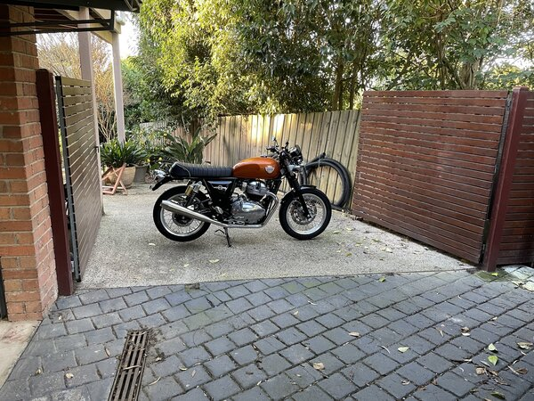

Joe Posted December 7, 2023 Posted December 7, 2023 On 12/7/2023 at 6:59 AM, Lucky Phil said: Buy yourself one of these. With a pair of AEW stainless silencers as shown it'll be about 90lbs lighter. Smooth as silk, abs, low C of G and parts are dirt cheap. Quality is very good. Can't go wrong. Expand INT 650 Orange Crush...
