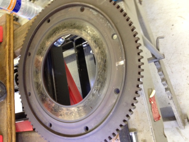

andy york Posted February 15, 2017 Author Posted February 15, 2017 Well. Measured the clutch discs....7.45 mm - both of them. I don't know what starting thickness is but I am impressed. I thought surely with 120k it was really close to being used up. Material to the rivet is about 2.5 mm. I figure at least another season on these discs. Flywheel looks good... no wear on the teeth....everything straight and flat.... no discoloration... Guess I will get a new slave cylinder and button it back up. I would be curious to try a lighted flywheel and ring gear from Guzzi power. Don't think I need to spend that kinda coin though. Now for a good cleaning 1

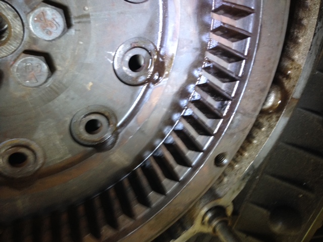

docc Posted February 15, 2017 Posted February 15, 2017 Well. Measured the clutch discs....7.45 mm - both of them. I don't know what starting thickness is but I am impressed. I thought surely with 120k it was really close to being used up. Material to the rivet is about 2.5 mm. I figure at least another season on these discs. Flywheel looks good... no wear on the teeth....everything straight and flat.... no discoloration... Guess I will get a new slave cylinder and button it back up. I would be curious to try a lighted flywheel and ring gear from Guzzi power. Don't think I need to spend that kinda coin though. Now for a good cleaning "No wear on the flywheel teeth?" None? Like, none at all? Take a pic! I'd like to have that to compare to my "low mileage" V11!
andy york Posted February 16, 2017 Author Posted February 16, 2017 thats correct... none at all ....no bumps,ridges,gouges,unevenness....just dirty. Oh no dampness...no oil can't post pictures never have been able to

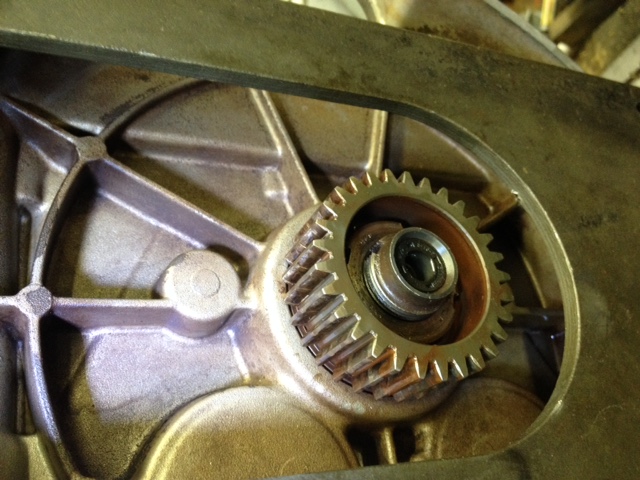

andy york Posted February 16, 2017 Author Posted February 16, 2017 Maybe just a very small amount of wear on the input shaft spline. .010 maybe. Other wise everything appears good. 1
docc Posted February 16, 2017 Posted February 16, 2017 I guess it is "inside" the flywheel I am wondering about. where the clutch discs clatter? (Nice pics, there, Perfesser! )
Chuck Posted February 16, 2017 Posted February 16, 2017 The input splines look pretty good. I've seen *much* worse. I guess it is "inside" the flywheel I am wondering about. where the clutch discs clatter? (Nice pics, there, Perfesser! ) Uhh.. where you see the wear is on the transmission input splines, and the clutch and intermediate plate splines. You can see light wear on Andy's. About 1/3 of it in the middle. I've seen much worse. His flywheel looks pretty good. The intermediate plate and pressure plate wear there.

docc Posted February 17, 2017 Posted February 17, 2017 The input splines look pretty good. I've seen *much* worse. I guess it is "inside" the flywheel I am wondering about. where the clutch discs clatter? (Nice pics, there, Perfesser! ) Uhh.. where you see the wear is on the transmission input splines, and the clutch and intermediate plate splines. You can see light wear on Andy's. About 1/3 of it in the middle. I've seen much worse. His flywheel looks pretty good. The intermediate plate and pressure plate wear there. This interface :
