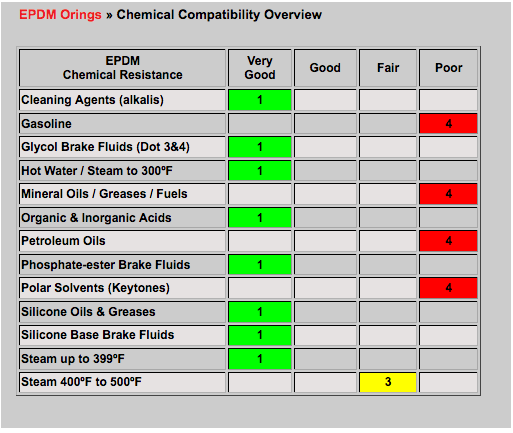

docc Posted July 7, 2017 Posted July 7, 2017 Yep: after a little searching I see one supplier specifically states "Buna-N" (Nitrile) is not recommended for auto/ aircraft brake applications. Looks like they need to be : EPDM (Ethylene Propylene) http://www.columbiaerd.com/epdm_orings.php McMaster Carr doesn't seem to have this material in square section metric. Any other suppliers?
