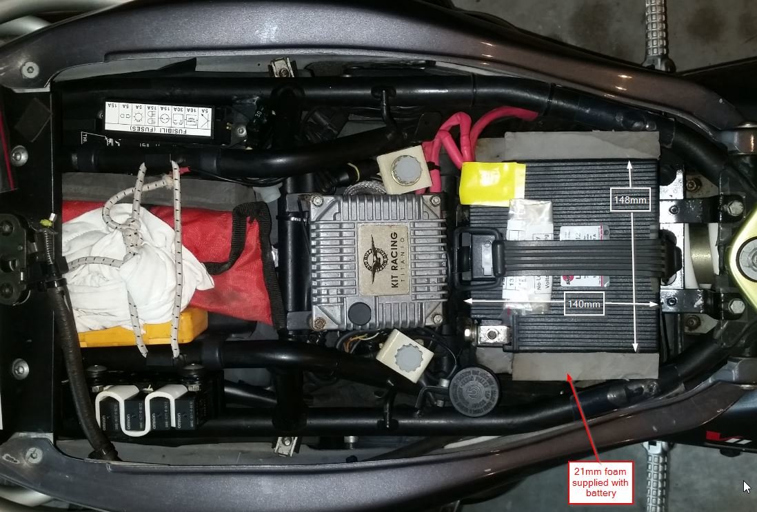

MartyNZ Posted February 19, 2020 Posted February 19, 2020 On 2/18/2020 at 6:30 PM, Gmc28 said: ... but thought i’d Ping Marty or whoever is running the Shorai regarding how things are shaping out now, a couple years later, in their lives with the Shorai in the V11... I'm happy with the Shorai LFX21L6-BS12 on my bike. It has given no signs of trouble over the last three years. It better not, given the price, though it does have a 5-year prorated warranty. I plug in the dedicated Shorai balance charger BMS01 a couple of times a year, as Shorai says "While standard lead-acid chargers can be used with Shorai LFX when needed, the BMS01 is specifically designed to charge, store, maintain, balance, and diagnose your LFX battery". 1

MartyNZ Posted February 20, 2020 Posted February 20, 2020 2 hours ago, Gmc28 said: How much smaller is the Shorai for the V11 than the comparable Odyssey? The Shorai LFX21L6-BS12 is 148 mm side to side, 82 mm top to bottom, 140 mm front to back, and weighs 1.36kg. It is the biggest model I could get that would fit in the stock cradle. I think the PC545 Odyssey is 177.8mm side to side, 85.9mm top to bottom, 131.3mm front to back, and weighs 5.7kg. 1
Tomchri Posted February 20, 2020 Posted February 20, 2020 6 hours ago, MartyNZ said: The Shorai LFX21L6-BS12 is 148 mm side to side, 82 mm top to bottom, 140 mm front to back, and weighs 1.36kg. It is the biggest model I could get that would fit in the stock cradle. I think the PC545 Odyssey is 177.8mm side to side, 85.9mm top to bottom, 131.3mm front to back, and weighs 5.7kg. Looks sorted looking at the Omron's, shake stoppers ? some soft material . More curious, those 2 white squares with adjusters or ? Cheers tom. 1
MartyNZ Posted February 20, 2020 Posted February 20, 2020 1 hour ago, Tomchri said: Looks sorted looking at the Omron's, shake stoppers ? some soft material . More curious, those 2 white squares with adjusters or ? Cheers tom. Sharp eyes. Yes, silicone foam tape is in there to reduce relays shaking in their sockets. I don't know how effective it is yet, but when I got the bike it had loose terminal sockets for some of the relays. A possible downside is a slight reduction in heat loss from the relays. Docc has written about relays getting hot. The white square covers are over single stud terminal blocks. All the cables to the battery will go there, and another cable goes to the battery. That's the plan, but I haven't got to finish that little job. 1 1
