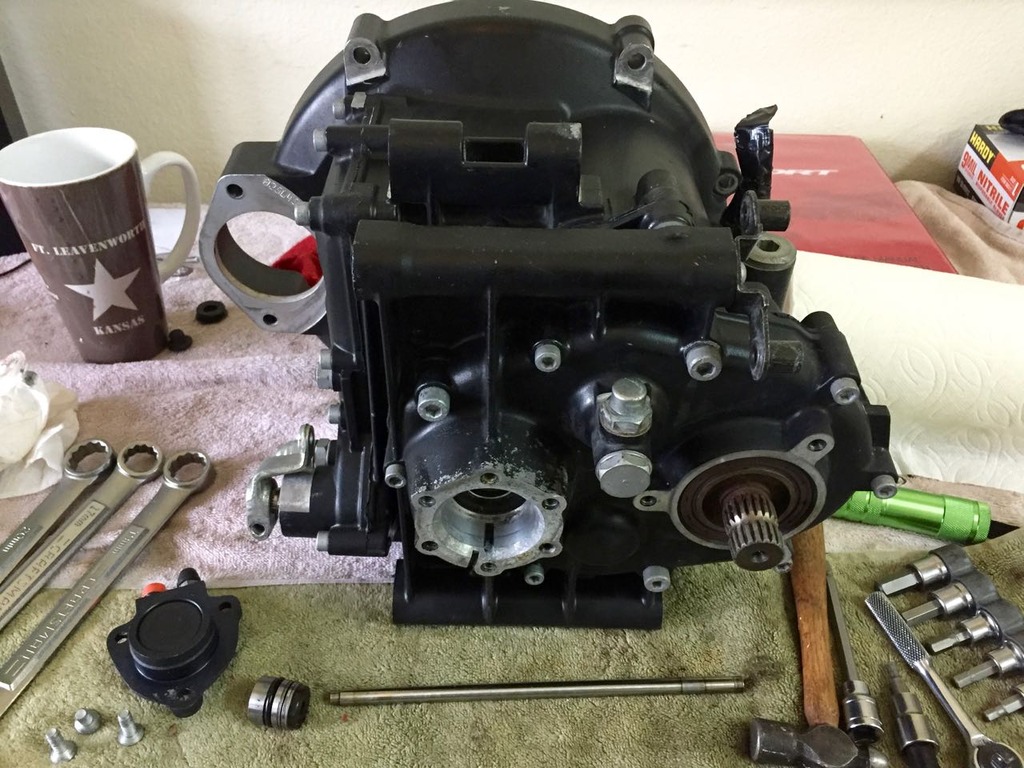

Scud Posted March 13, 2017 Author Posted March 13, 2017 I got this transmission from eBay. The tranny was $500 and the seller said it was from a Nero Corsa, was in good shape, had about 20,000 miles, and had never been opened. I bought it a few months ago - in response to getting dealer quote of $500 just to open and inspect the transmission from my LeMans - and that was if I took it out of the bike. That was from the local BMW dealer who recently stopped carrying Moto Guzzi. That was also before I had gotten into a tranny for the first time and I was still intimidated by it. So, it cleaned up pretty well, and what I thought might be a leak appears to have been accumulated gunk. I gave it a quick flush with diesel fuel to get some more of the Redline heavy out. Cleaned the sight glass and breather, cleaned out the slave cylinder cavity. And the (nearly unobtainium) slave looks in good shape. The verdict - it runs through all the gears and there is no perceptible play of the output shaft in any gear, nor in neutral. If this transmission works, I'll do an autopsy on the other one to see why it's been having a hard time with 3-4. And maybe LowRyter will get a transmission case to paint silver for his leaky greenie.

docc Posted March 15, 2017 Posted March 15, 2017 As I said here, back in 2003, ya'll are The World's Foremost Experts on the V11 6Speeder! I love this photo - so much going on. The Knolling of the tools, the V11 Workshop Manual in the background, a full-on ball-peen hammer, adequate toweling (don't tell mama!), LED flashlight, and Nitrile gloves are all so reassuring . . . . . . . . then the troubling *Leavenworth* coffee mug shows itself.
Scud Posted March 15, 2017 Author Posted March 15, 2017 That's how I knoll, baby. I do some work for the US Army in Fort Leavenworth once or twice a year. The joke, of course, when one goes to Leavenworth, is: "Why, what'd ya do?" To explain for members outside US, there are a few prisons in Fort Leavenworth, including a Federal Penitentiary and the Army's maximum security prison. If you get sent to Leavenworth, you're gonna be there a while.
