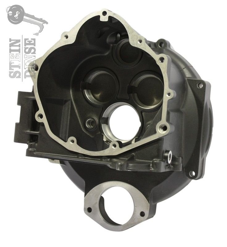

Rolf Halvorsen Posted April 4, 2019 Posted April 4, 2019 Thin walled cast cheap aluminum-alloy. Difficult to make a good repair. Change the house to a new house (matt black - not wrinkcle paint). I have this part available for you. Part No: 01200290 Rolf

Rolf Halvorsen Posted April 5, 2019 Posted April 5, 2019 This new case comes from the 2004-series V11 Sport. I have not heard of any such models having problem with cracking gearbox house. They are 100% identical with the first 2000-models, but many things may have been changes to the better in the production. Alu-alloy, casting prosess, bigger radius in corners etc. Why use time and energy in trying to repair, when you can just put in a new part. I think the cost will be around the same level. Rolf 1

LowRyter Posted April 5, 2019 Author Posted April 5, 2019 11 hours ago, Rolf Halvorsen said: This new case comes from the 2004-series V11 Sport. I have not heard of any such models having problem with cracking gearbox house. They are 100% identical with the first 2000-models, but many things may have been changes to the better in the production. Alu-alloy, casting prosess, bigger radius in corners etc. Why use time and energy in trying to repair, when you can just put in a new part. I think the cost will be around the same level. Rolf wish I'd known you a couple years ago
