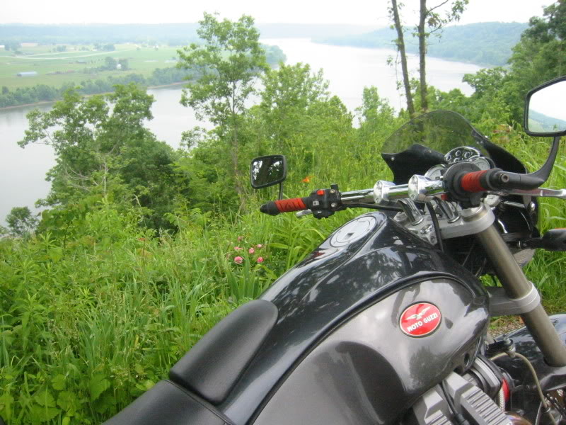

Chuck Posted March 22, 2017 Posted March 22, 2017 you need gorilla arms to fit the sport 1100, 99-01 early red frame was twitchy as stated, I'd say you need gorilla hands for the 1100 Spot.. but twitchy is a matter of degree. The early V11S turns in a *little* faster, but nothing like the Monza or Lario. 2016-08-18_02-45-05 by Charles Stottlemyer, on Flickr 1
