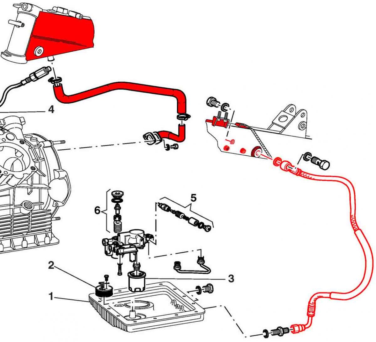

sp838 Posted March 27, 2017 Share Posted March 27, 2017 I know these questions can get people riled up, but I'm curious to know if anyone has a good explanation for what the small sump breather hose does and if it is really all that necessary. Not talking about the big crank case breather, but rather the smaller hose on the back of the sump, that connects to the left of the drain plug. Seems like the crank breather should be enough to handle breathing duties, no? I would really love to get rid of it, if it's not really contributing much to the overall effort. Link to comment Share on other sites More sharing options...
Camn Posted March 27, 2017 Share Posted March 27, 2017 Isn’t it so that the breathing system of V11 is among the best in Guzzis? Oil fumes travel with the ”breathing air” along the large breather pipe up, to the upper part of the (spine) frame. The frame tube is hollow, and works as a liquifier. The main part of the small oil drops in the oil fumes are separated. The air, is directed to the suction box and from there, to motor with the intake air (a part of this oil stays on the bottom of the suction box). The separated oil flows with gravity inside the main frame tube to the bottom of it, and from there, along this small pipe (which was the quesiton), back to the sump. But why there is no ”one way valve” at the breather pipe outlet on V11? Many other models with the 2V big block do have it… maybe because of the breathing system itself... Link to comment Share on other sites More sharing options...
jchayes Posted March 27, 2017 Share Posted March 27, 2017 Yeah, that ain't a "breather," that's the oil return line from the crankcase blow-by oil/vapor separator. Link to comment Share on other sites More sharing options...
sp838 Posted March 27, 2017 Author Share Posted March 27, 2017 Right, it's the oil return for the crank breather. So the question is, how much oil comes back down from there? If it's negligible, it could be capped off. Just top oil off every so often, and then drain it when doing oil changes, could be possible. If it doesn't affect the breathing of the engine, and if lots and lots of oil doesn't get spat up in there, shouldn't be an issue deleting it right? Link to comment Share on other sites More sharing options...
MartyNZ Posted March 28, 2017 Share Posted March 28, 2017 Right, it's the oil return for the crank breather. So the question is, how much oil comes back down from there? If it's negligible, it could be capped off. Just top oil off every so often, and then drain it when doing oil changes, could be possible. If it doesn't affect the breathing of the engine, and if lots and lots of oil doesn't get spat up in there, shouldn't be an issue deleting it right? You could prove to yourself whether you need the oil return hose by putting the hose into a temporary collector bottle, then going for a fast run. (after blanking off the the sump fitting of course). A split in my old breather hose meant two drips of oil out the bottom of the clutch housing everywhere I stopped, and probably faster drip rate with the engine running. Even with the split, I think most oil vapor was still getting up into the spine, and then to either the airbox or the sump. I think that this probably means that the return oil flow is more than negligible, depending on many things like power setting, rpm, oil temp/quality/quantity, Roper plate installed, piston ring wear... If you try it, can you let us know what you find out? Link to comment Share on other sites More sharing options...
GuzziMoto Posted March 28, 2017 Share Posted March 28, 2017 In my experience there is a fair amount of oil that is collected and returned to the sump. I did run that for a time into a catch bottle on my Daytona. I switched it back after a while as it was a fair amount of oil. It is actually a well designed system as long as it is in working order. My issue with the Daytona was that the frame was not oil tight, so it leaked. I ran the breather to a catch bottle to stop it dripping out of the frame. After a while I decided that was too much oil and I sealed the frame so I could route the breather back into the frame. The stock set up works very well and does not cause issues, unless something is amiss. I would not change it. It isn't harming anything and it did catch a lot of oil on my Daytona. 1 Link to comment Share on other sites More sharing options...
sp838 Posted March 28, 2017 Author Share Posted March 28, 2017 I'm thinking I might install a check valve on the crank breather, then replace the return line with a length of clear hose with a plug in it. Then I can have a visual on how much is being returned. I can always revert to stock if it's looking like there's a lot of oil that wants to come back. I do have a Roper plate installed fwiw. Link to comment Share on other sites More sharing options...
Scud Posted March 29, 2017 Share Posted March 29, 2017 It's a lot of oil. I recently left the breather hose disconnected by accident. Rode 4 miles - oil everywhere. It was a perfect topper to my clutch frustrations (now solved). 1 Link to comment Share on other sites More sharing options...
