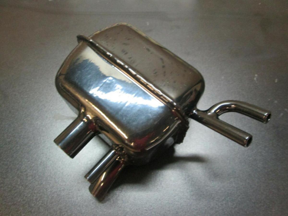

68C Posted March 31, 2017 Posted March 31, 2017 Still don't understand why you want to remove this pipe. It was common to fit a LeMans Mk1 breather box to the 850T3 which let oil run back to the sump but allowed gasses to vent to atmosphere and not into the airbox, less chance of oil deposit build up on the inlet valve. The metal box was about 3" x 2" and sat between the carbs, it had an internal rubber flapper valve which ensured a low pressure in the crankcase, worked really well and lasted a long time. As the original airbox would not fit you then fitted K&N filters. I can understand if you want to reroute the pipe that goes goes to the airbox but not why you want to stop the oil running back to the sump. Of course, allowing the gasses to atmosphere has an enviromental effect which is why the OEM choose to burn them through the engine.
