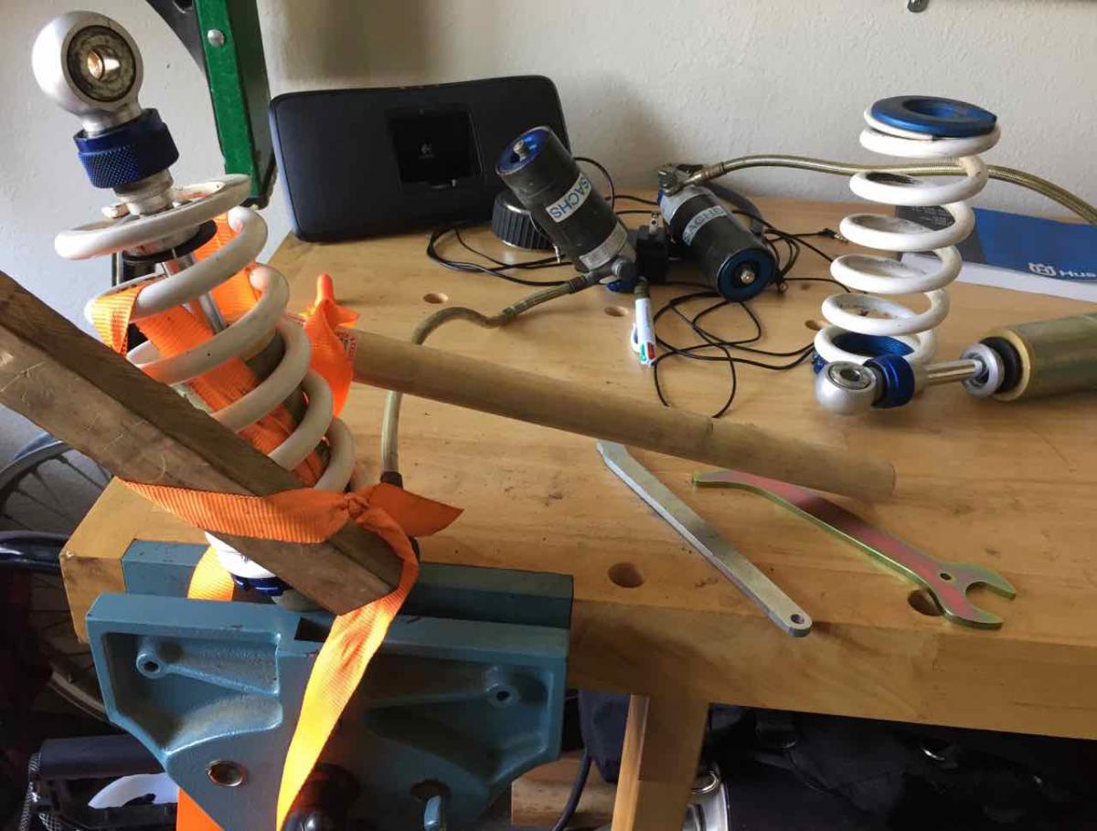

Scud Posted July 1, 2017 Author Posted July 1, 2017 How do you like my spring compressor tool? And here is Czakky's old shock, installed on the Greenie (but with spring and shiny blue bits that were originally on the Greenie). Thanks again. That's one thing off the garage floor today. And the offending crack on the lower mount of the original shock. Does the shock with the crack have any value to anyone - or is it trash? 2

Scud Posted July 3, 2017 Author Posted July 3, 2017 How do you like my spring compressor tool? Uhhhhh.. Aw c'mon Chuck. It's cheap, effective, and there's a high risk of injury if the tourniquet sticks start spinning like propellors.

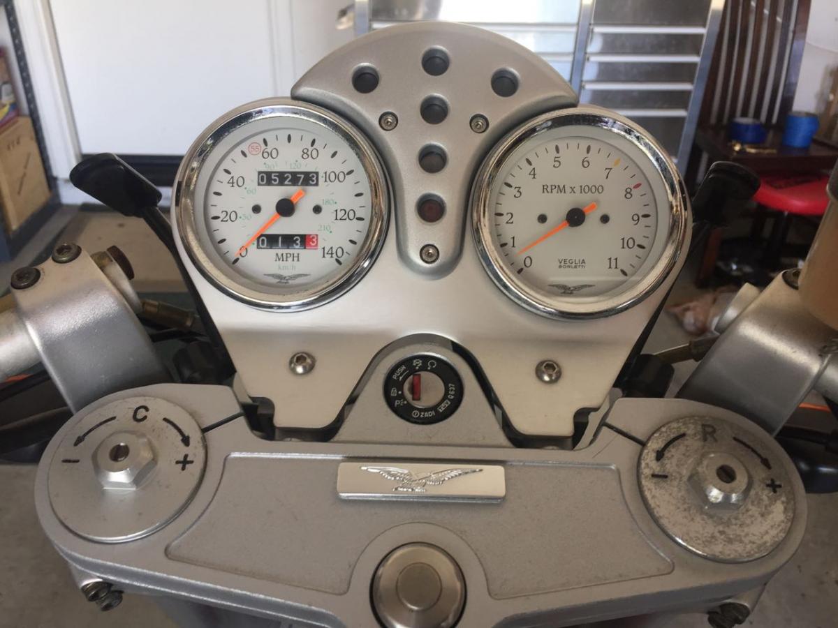

Scud Posted July 3, 2017 Author Posted July 3, 2017 ...and here's how the aluminum paint looks on the light cover. I think it's a pretty good match for all the other silver stuff up there. I also replaced the rusted-chrome top-nut with a brushed one from a 2002 bike and replaced the aguila badge. Now, what to do about those fork caps?
Chuck Posted July 3, 2017 Posted July 3, 2017 ...and here's how the aluminum paint looks on the light cover. I think it's a pretty good match for all the other silver stuff up there. IMG_6461.jpg I also replaced the rusted-chrome top-nut with a brushed one from a 2002 bike and replaced the aguila badge. Now, what to do about those fork caps? You're going to have to move some metal to make them look like new. If that's the goal, the caps have to come off to start.. then.. patience, tongue depressor, various grades of paper.. I'd say around 260 through 500 grit.. polishing compound.. oh that's too much trouble. Maybe chuck them up in a lathe and sand em.. Uhh.. soda blast? That sounds easy. Dunno.
