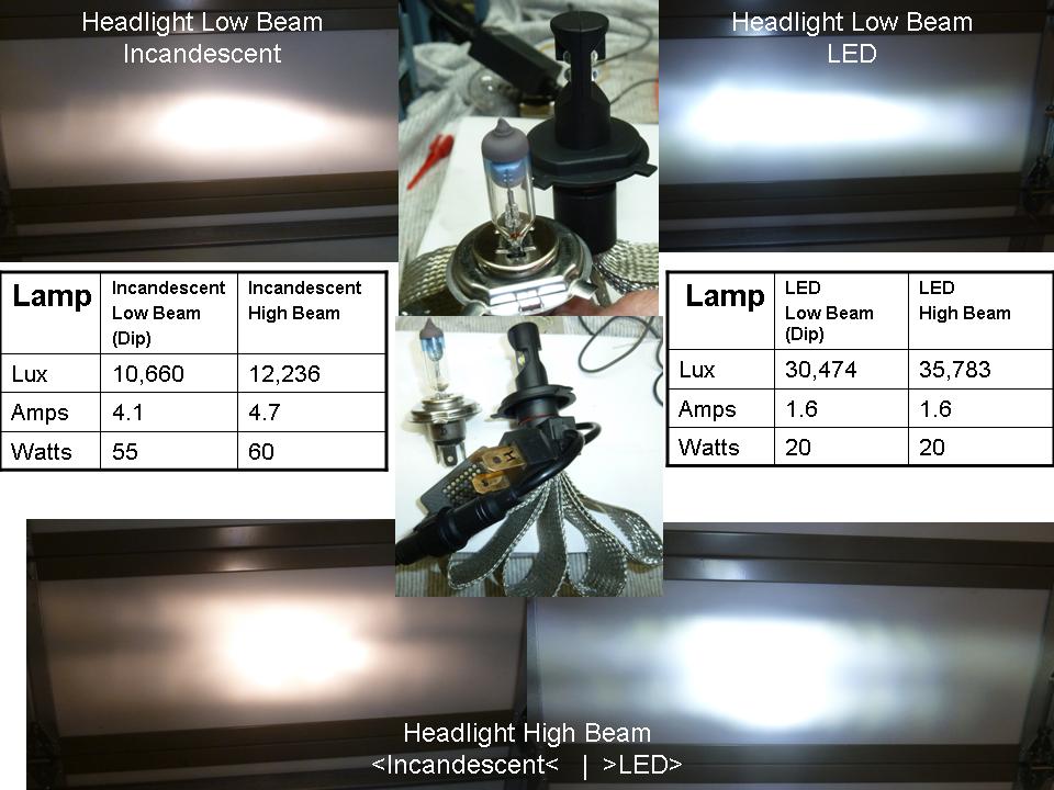

MartyNZ Posted May 21, 2017 Posted May 21, 2017 It looks like the lumen output for the standard incandescent H4 is ~910 lo / ~1800 hi. I actually measured my headlight lux output before & after using a phone app, not that accurate, but it gives a comparison. BTW lux is lumens per Sq metre, so lux is a more useful unit.
docc Posted May 21, 2017 Author Posted May 21, 2017 Man, i didn't realize that you produced that comparison. I thought it was from some commercially produced source. Well done! Very good point on the matter of Lux versus Lumen, yet manufacturers only typically publish the latter? It appears your Cu LED produces about triple the "light?"
MartyNZ Posted May 21, 2017 Posted May 21, 2017 It appears your Cu LED produces about triple the "light?" Well yes, triple the light from a dim Phillips 55/60 watt halogen lamp. There are brighter halogen and xenon incandescent lamps about.

MartyNZ Posted May 21, 2017 Posted May 21, 2017 You can expect 50,000 hours from a low power LED, and about 10,000 hours from a high power LED like a headlight. That should be enough...
