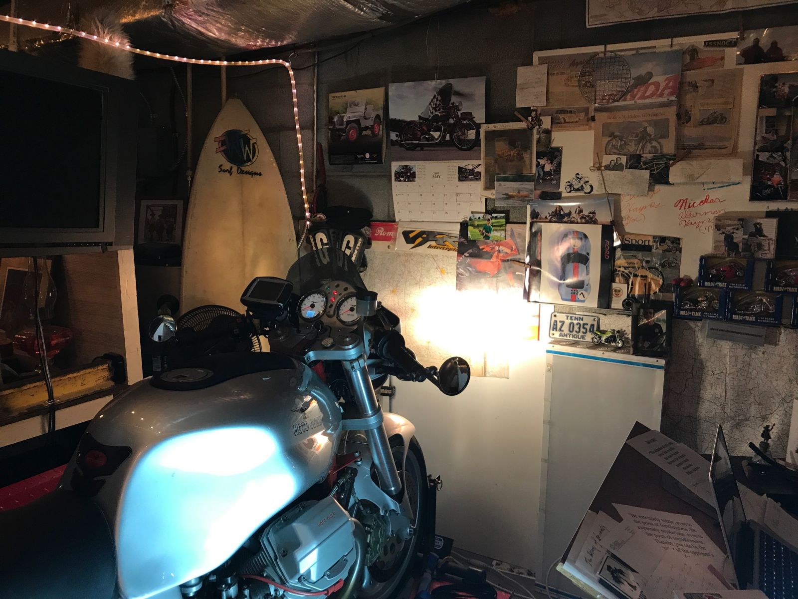

docc Posted June 6, 2017 Author Posted June 6, 2017 I think it's hard to take photos and represent the changes to the light, but here we have the incandescent H4 followed by the 4000 lumen LED unit, both on hi-beam:
docc Posted June 6, 2017 Author Posted June 6, 2017 I'm thinking this is not the 4300 Kelvin I was expecting. Looks "hotter" to me . . .
