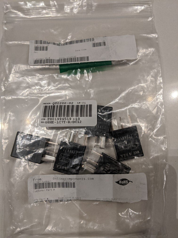

4corsa Posted July 29, 2020 Posted July 29, 2020 Received my 10-pack of new Omron relays from Online Components (thanks Docc), and installed the 5, all good. That leaves 5 for anyone who needs them. $20 shipped within the continental US. 1 1
