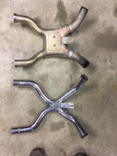

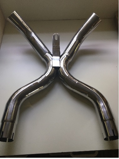

OH BOY! another crossover post.
Just received my X-type crossover from Ghezzi&Brian.
Cannot wait to put it on, and hear/feel the difference.
I already have the MG "Race" ecu, so it should be good to go without any fuss.
Should save 20lbs of exhaust system weight, and I'll be able to change the oil without the mess.
Hopefully, say good bye to that 4-4500 rpm hole.

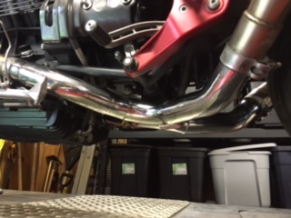

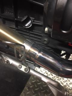

Everything installed OK.  Had to do a little shifting around to get everything aligned.  The kickstand would make contact with the front clamps.  The G&B clamps are the size of the stock rear clamps.  The stock fronts were spot welded into place, so I could not use the stock clamps.  Bent the rubber kickstand bumper down a bit, and everything was well.  Stock crossover and cat was lighter than I would have thought.  Maybe only 5lbs saved.
Sounds much deeper than the stock arrangement.  I have BMC filter, FBF pipes, MG race ECU.  Rainy day here, so waiting to take it out.

(Hmm . . .  catalytic converter in the factory US crossover? )

So does it actually crossover or just kiss?
I'd have thought they must connect.
They don't technically have to.
Hmm.. they don't have a cat converter just a big space, right?
Sure, i just meant these look like they do..
There's a perforated flat baffle in the factory crossover, but no cat(alytic converter) AFAIK.

Crossover - split pipes or shared flow.  Sorry, I did not shine a flashlight in one pipe to check.  Assumed there was shared flow.  I did send email to Brian, But I bet he never replies because it's an implied function of a crossover.
After some drama, I finally got to ride the bike last night.
The 3500-5K hole is gone; wow!
Top end did not feel OMG stronger, and quite frankly, with the bike's mass and tall gearing it is subjective on the butt dyno.
Engine does feel smoother, and I'll assume because there are fewer flat spots in power output; again subjective butt dyno.
Since I have the MG race ECM, the combo of BCM air filter (no lid), crossover, and cans all seem to like each other.

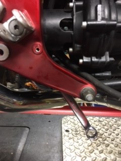

After fishing on the internet, it became abundantly clear that there aren't many rearset options for the V11.
I don't understand all the V7 love.
I hadn't looked before because I had installed the Buell step-down footpegs when I bought the bike new.

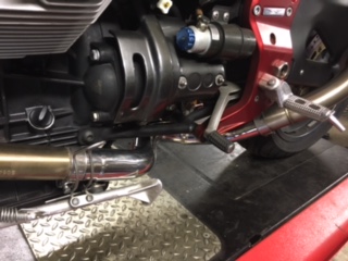

I ended up ordering the Motobits rearsets.
They are very NICE!
The 45mm forward positioning was immediately noticeable; even with my 32in inseam.
Instructions were good, and the materials seem to be well made.
Only clarifications I would make would be:
1 - Pointing out to remove the nut from the stock footpeg base to use a long 17MM wrench from the bottom.
2 - Removing the funky shaped shifter out first; no need to loosen the starter.
Included a few pics.
