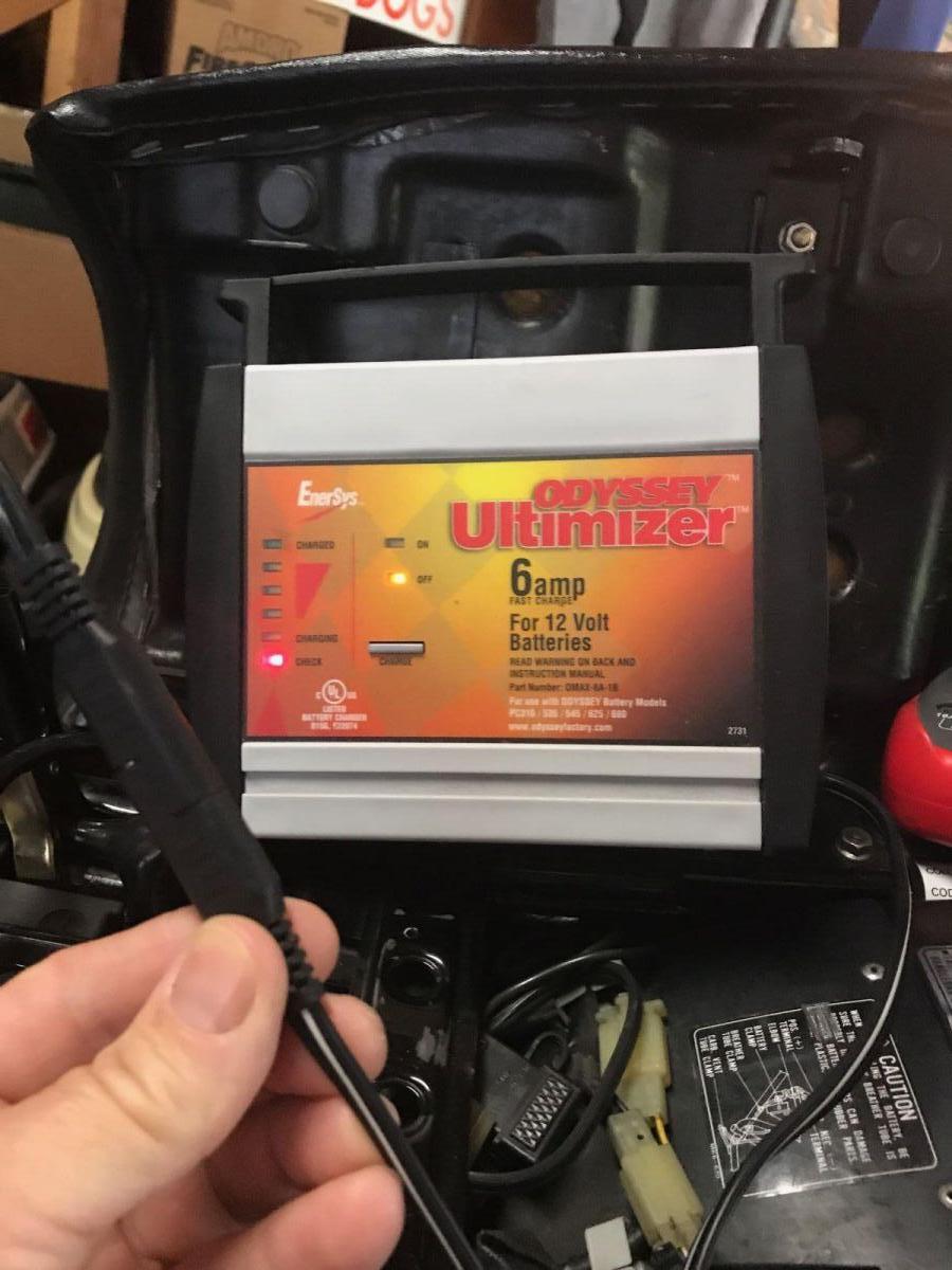

docc Posted May 25, 2017 Author Posted May 25, 2017 I found the problem. It was not the PC545 or anything I did. Broken wire at the connector for the charger. 1
docc Posted May 26, 2017 Author Posted May 26, 2017 did you find a connector & repair it ? I need to source an SAE connector and repair the adapter. In the meantime, I'm plugging the charger directly into my fused accessory connector on the bikes. That might be a better method regardless.
gstallons Posted May 26, 2017 Posted May 26, 2017 If it is the connector you are holding , you can get them at a good (old) electronics store .
docc Posted May 26, 2017 Author Posted May 26, 2017 SAE connector ? If it is the connector you are holding , you can get them at a good (old) electronics store . Yes. And: yes, we actually have one of those here. They have helped me immensely with all of the wiring projects I have foisted upon my Guzzi. Looks like an LED headlamp unit could be next . . . I've been reluctant to plug the 6 amp charger into my SAE accessory connectors. I have long opted to clamp the charger to the battery terminals. It's the connector on the adapter cable that failed. The accessory connectors are fused for 10 amps, so they should be fine to use for this 6 amp charger. Finding the actual fault is quite a relief, of course. Because of all the Brain Salad Surgery on the Sport's instruments, I simply assumed I had screwed something up and injured the battery.

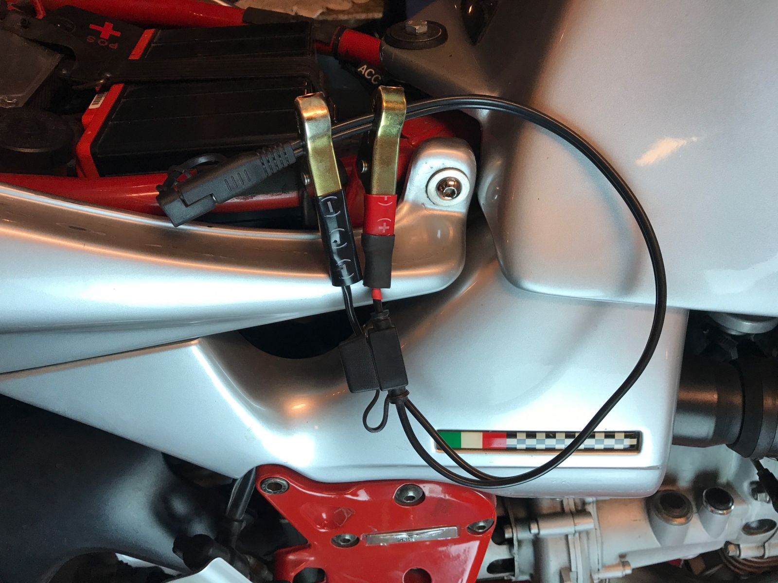

docc Posted May 28, 2017 Author Posted May 28, 2017 Made up a really solid, 10 amp fused, connection cable for the charger. The one that came with it was (obviously) crap.
gstallons Posted May 29, 2017 Posted May 29, 2017 You will probably have to bump the fuses up to 15 or 20a to keep from replacing them ( I know ) often .
