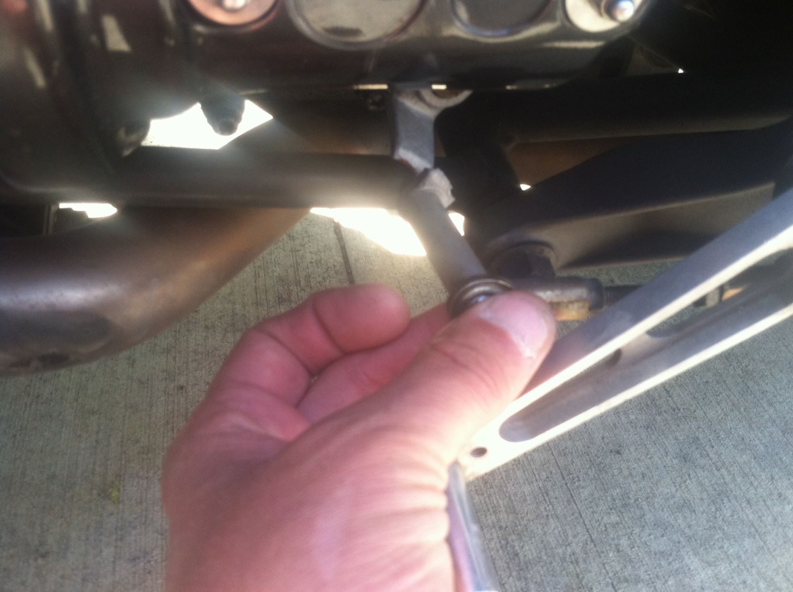

Shiny Mike Posted May 29, 2017 Posted May 29, 2017 I'm looking for the bolt that goes from the spline to the the shifter.Mine broke.It's pot metal.I'd buy yours or if you can tell me where I can get one ASAP that would be great. Thanks Shiny Mike 440 623 3356. [ edit: I ordered it from the dealer.Hold on to your hats! 134.00 plus tax = 140.40 out the door! ]

Craig Posted June 2, 2017 Posted June 2, 2017 What the heck is that thing? My shifter doesn't have anything like that cantilevered fitting. That is just a disaster waiting to happen.
docc Posted June 3, 2017 Posted June 3, 2017 I'm hoping you guys can help Shiny Mike figure out what this shifter is (it's not factory). We'll probably need a couple more pictures and I don't have them. I've never seen that shift lever break.
Scud Posted June 3, 2017 Posted June 3, 2017 That break is not too surprising. That's some kind of aftermarket shifter that I bet also lowers the pegs. The arm that goes on the transmission input shaft is rotated down to accommodate the out-board linkage. The long bolt seems to put an undue twisting stress on the arm. The original linkage makes a direct connection to the arm - and it's all in-board (inside the porkchops - aka stilettos). 1
gstallons Posted June 3, 2017 Posted June 3, 2017 Yhis one pic we are looking at is way off on everything. My lever that is on the shift shaft ( if I remember ) is pointing at about 1 o'clock position . and the rod attatches directly to it. This mess that is on Mike's is going to break EVERY time .
Scud Posted June 3, 2017 Posted June 3, 2017 I wonder if that bolt extension hits the lower leading edge of the porkchop (stilletto) during downshifts - or if the arm contacts the subframe? That would break it off in a hurry.

Tom M Posted June 4, 2017 Posted June 4, 2017 That's a Motobits kit and it's known weakness is that it puts too much torque on the stock shifter arm. I replaced mine after I had maybe 12k miles on it and the shifter arm was starting to crack. Last winter I had the cracks on the old part welded and had some plates welded to the sides of it too. It's installed now and I don't expect that it will ever be a problem again. I think I paid about $30 for that part a few years ago? Here's a pic of my beefed up part next to the stock one. 1
Shiny Mike Posted June 5, 2017 Author Posted June 5, 2017 Ok.Ill post more pictures. Tom M said he got 12k out of his shifter.My bike has 12 on it now. The P.O. said that all the after market on the bike was on it before he bought it in 2006 with 2000 miles on it. I would guess the shifter was put on just after the first owner bought it. I have the stock shifter and pegs. The after market a good 1.5 to 2 inches away from the bike. With my size 14 shoe I think I'm going to leave the after market on it.I'm going to have the part in question made out of billet I think.
