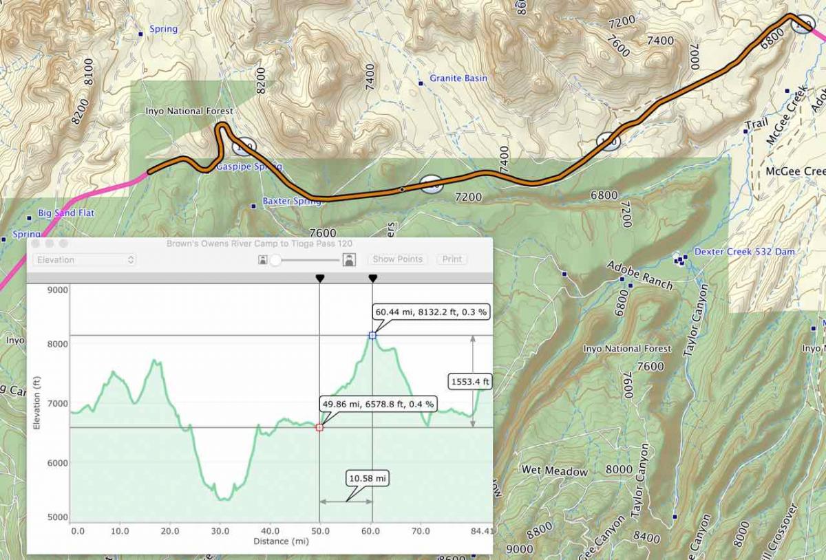

Scud Posted June 2, 2017 Posted June 2, 2017 On my recent trip the Sierra Nevadas the LeMans felt a bit weak, especially at higher elevations. During the weekend, I never got below 5,000 feet, nor above 9,000 (blocked by snow). I've been running the valves kind of loose: .008" I and .010" E. My house is at 100 feet above sea level - so that's where I tune it. So... I'm wondering if a loose valve setting could cause a bit of an intake restriction in thinner air. I can't do any quick tests... so this is a "theoretical" topic. Edit - I am assuming that the looser the valve clearance, the shorter the duration of time the valve is open. So if the air is thinner, it might not get enough oxygen to burn the fuel. I also noticed some small pops on deceleration at the highest elevations - mini backfires - which made me think that unburned fuel was igniting in the exhaust. Am I thinking about this the right way?

Scud Posted June 2, 2017 Author Posted June 2, 2017 Well, it's not really a big problem - just a puzzle about optimum tuning for big elevation changes. I missed doing the Sherman Pass (9,500 feet) last season and want to try it again this summer. The bike just didn't have the brutish punch on the high climbs, it felt like it would only go 3/4 throttle. However, it did manage to run sections of this long incline in 6th gear and 5-6k rpm. It idled a little rough when I stopped at the peak to soak in the view.
