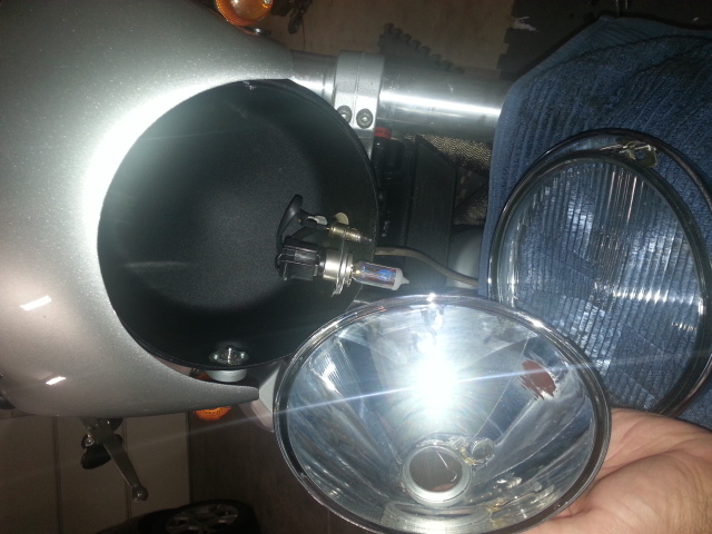

LeMaynes Posted June 13, 2017 Author Posted June 13, 2017 The easiest areas to tear into on a naked with just a small screw driver. I would rather provide detail photos than pontificate the issue, so we will see what I can offer tomorrow.

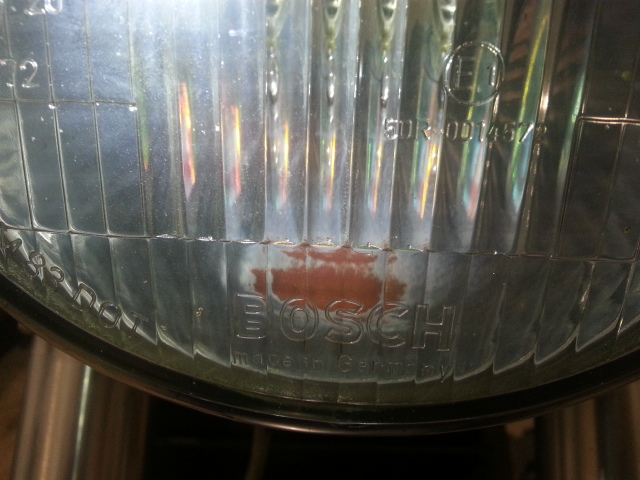

LeMaynes Posted June 14, 2017 Author Posted June 14, 2017 Nothing is inside that could be scraping. Can it be rechromed? Label reads BOSCH 0303850103. The light it shines is very colorful. Upon inspection it looks like that is coming from the bulb glass. A new bulb is in order but even with it the redish part of the beam is coming from the blemish of the reflector.
swooshdave Posted June 14, 2017 Posted June 14, 2017 Is that rust? Headlights aren't chrome. They aren't a high wear part so they should be available used.
docc Posted June 14, 2017 Posted June 14, 2017 That looks to be a *bruise* from where the integrated reflector fell off and rubbed around on the surface. 1

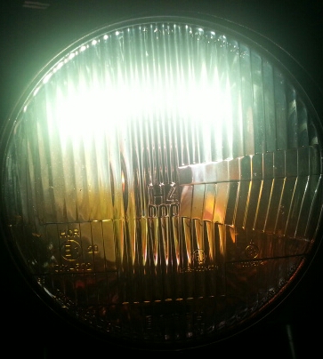

LeMaynes Posted June 15, 2017 Author Posted June 15, 2017 It is not rust. But if there was something rattling around in there, that is where it would leave its mark. Sure is hard to take pictures of this darn thing. You can see from the back of the reflector that it is painted with a red oxide primer before the mirror coating. The location of the blemish inside transposes between the yellow sticker and the outer edge. Anyone got a pic of the "integrated reflector" I seem to be missing. I have scoured the web, workshop manuel and parts catalog to no vail. Maybe its just time to splurge on a trucklite or one from JWS. Fix a necessity as is? or might as well upgrade to something super badass.

LeMaynes Posted June 16, 2017 Author Posted June 16, 2017 YES. I can see where those feet would attach. I guess there is no harm in running without it. As long as it not still in there rattling around like it did. Any ideas on how to touch up or refinish the reflector?
docc Posted June 16, 2017 Posted June 16, 2017 Doesn't someone make "chrome" colored paint (maybe Rustoleum's metallic series or VHT)?
sculler2x Posted June 16, 2017 Posted June 16, 2017 I say forget about it and put in one of the CNSUNNY LED replacements. The LED replacement does not use that portion of the reflector anyway. 1
swooshdave Posted June 16, 2017 Posted June 16, 2017 On 6/16/2017 at 12:11 PM, docc said: Doesn't someone make "chrome" colored paint (maybe Rustoleum's metallic series or VHT)? Yes, but I would only touch up the affected area and not try to spray the whole thing. 1

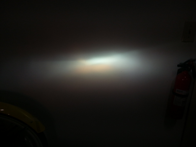

LeMaynes Posted June 17, 2017 Author Posted June 17, 2017 What is the purpose of the pilot bulb? Mine is burnt out. Never new it was there until I opened the headlight. Here is another pic showing how bad that blemish affects the beam.
footgoose Posted June 17, 2017 Posted June 17, 2017 how about a small piece of reflective hvac duct tape. it looks chrome and has a very sticky side.
