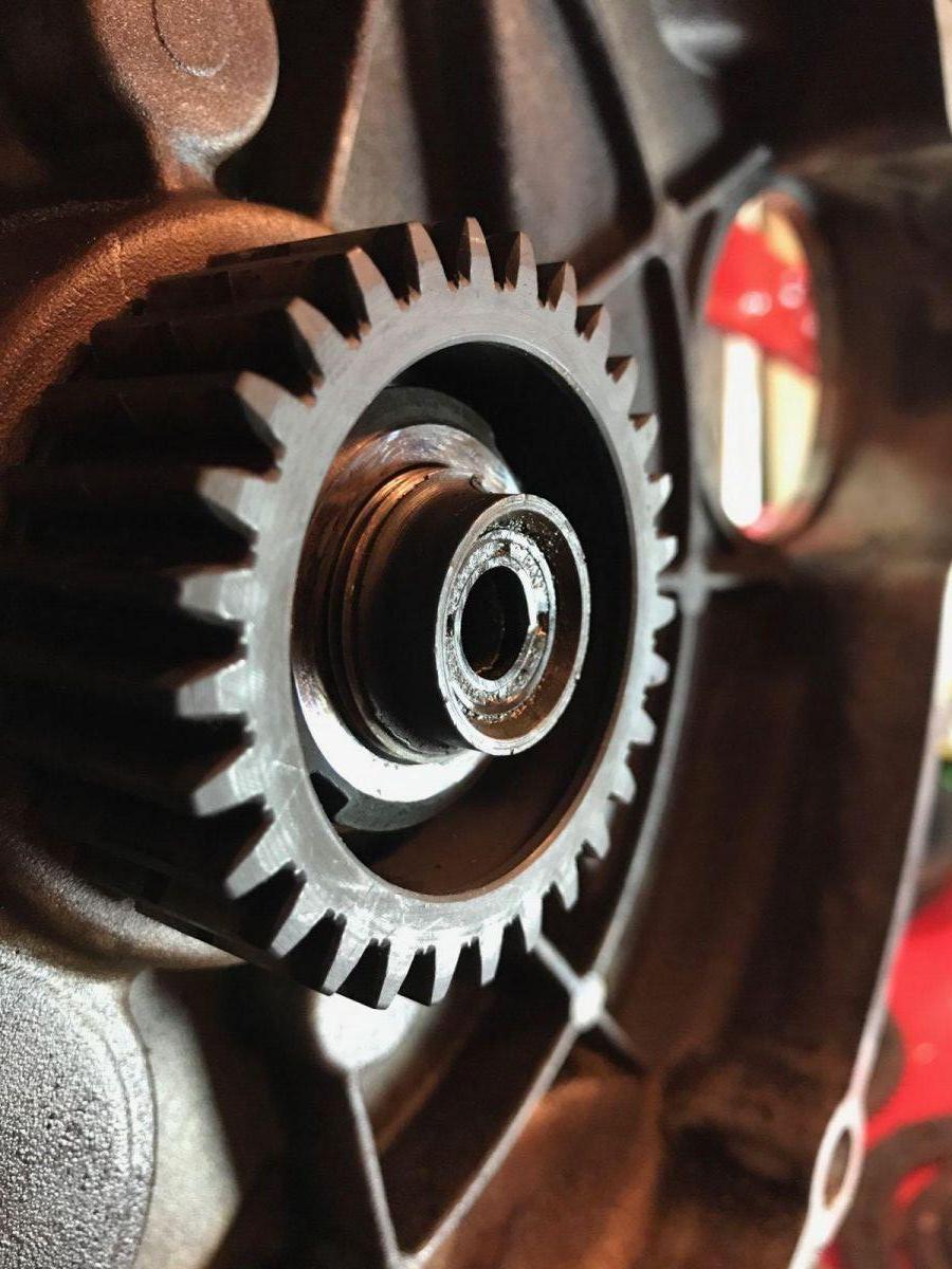

docc Posted July 19, 2017 Author Posted July 19, 2017 So, no doubt, my clutch went "sticking" because the safety washer failed to retain the input hub to the gearbox. Check out the position of the lock nut. Hanging on by "two threads!" . . . (You can actually see where the lock nut has been engaging the pushbutton on the pressure plate.)

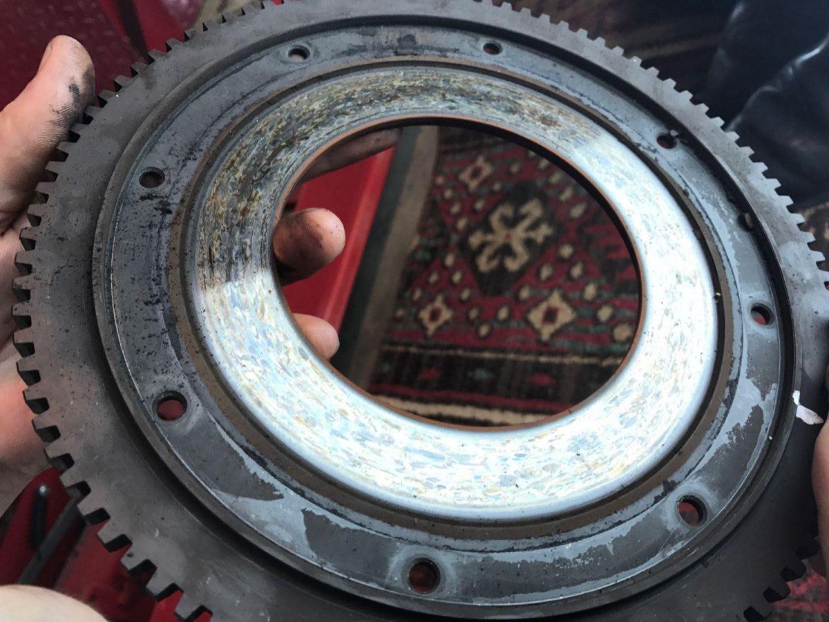

Scud Posted July 19, 2017 Posted July 19, 2017 So... after all this discussion about possible replacements I'll just throw in what I would do if this was my bike: new seals where leaking, 5 new stiffer clutch springs (alternate with 5 originals), new throwout bearing (preventative measure). From there, measure the other clutch internals - and run them as-is if possible.I've seen pictures of much worse input hubs and flywheels.You can always do a complete replacement later - during the winter.Sent from my iPhone using Tapatalk
Scud Posted July 19, 2017 Posted July 19, 2017 And of course a new "star" washer. Sent from my iPhone using Tapatalk
docc Posted July 19, 2017 Author Posted July 19, 2017 And of course a new "star" washer. Sent from my iPhone using Tapatalk Yes, indeed! And a tab properly engaged well into the lock nut!
docc Posted July 19, 2017 Author Posted July 19, 2017 So... after all this discussion about possible replacements I'll just throw in what I would do if this was my bike: new seals where leaking, 5 new stiffer clutch springs (alternate with 5 originals), new throwout bearing (preventative measure). From there, measure the other clutch internals - and run them as-is if possible. I've seen pictures of much worse input hubs and flywheels. You can always do a complete replacement later - during the winter. Last thing first: Here in the Deep, Humid, Stormy Southern USA, *now* (summer) is the time to refit as long as one has a place free of mosquitoes where the sweat doesn't obscure clear vision. Contrary to popular belief, alligators are not conducive to 'firing another round.' All the seals/gaskets have to be done regardless. #1) Looks like a pair of friction plates, intermediate plate, new springs, with new flywheel fasteners and Schnorr washers will be under $300US. ("Normal Maintenance?") Add #2?) Adding the Guzzi crown gear and pressure plate: another ~$600US. (The "Make-Sure/Once-and-Done?") Plus #3?) Also replace the flywheel and the input hub? $unknown$ . . . (The "Over-the-Top/OMG/replace-everything?") Closing in on two grand? Or #4) RAM complete assembly (plus *sourced* input hub and "machined" pushrod) ~$785? (The "Unknown Quantity?") One unanswered question (among the many), can these surfaces be restored?
docc Posted July 19, 2017 Author Posted July 19, 2017 I made up my mind. This is normal maintenance/ normal wear. No failure (beyond the "safety washer" letting the input hub walk off the gearbox input shaft). No actual damage.
