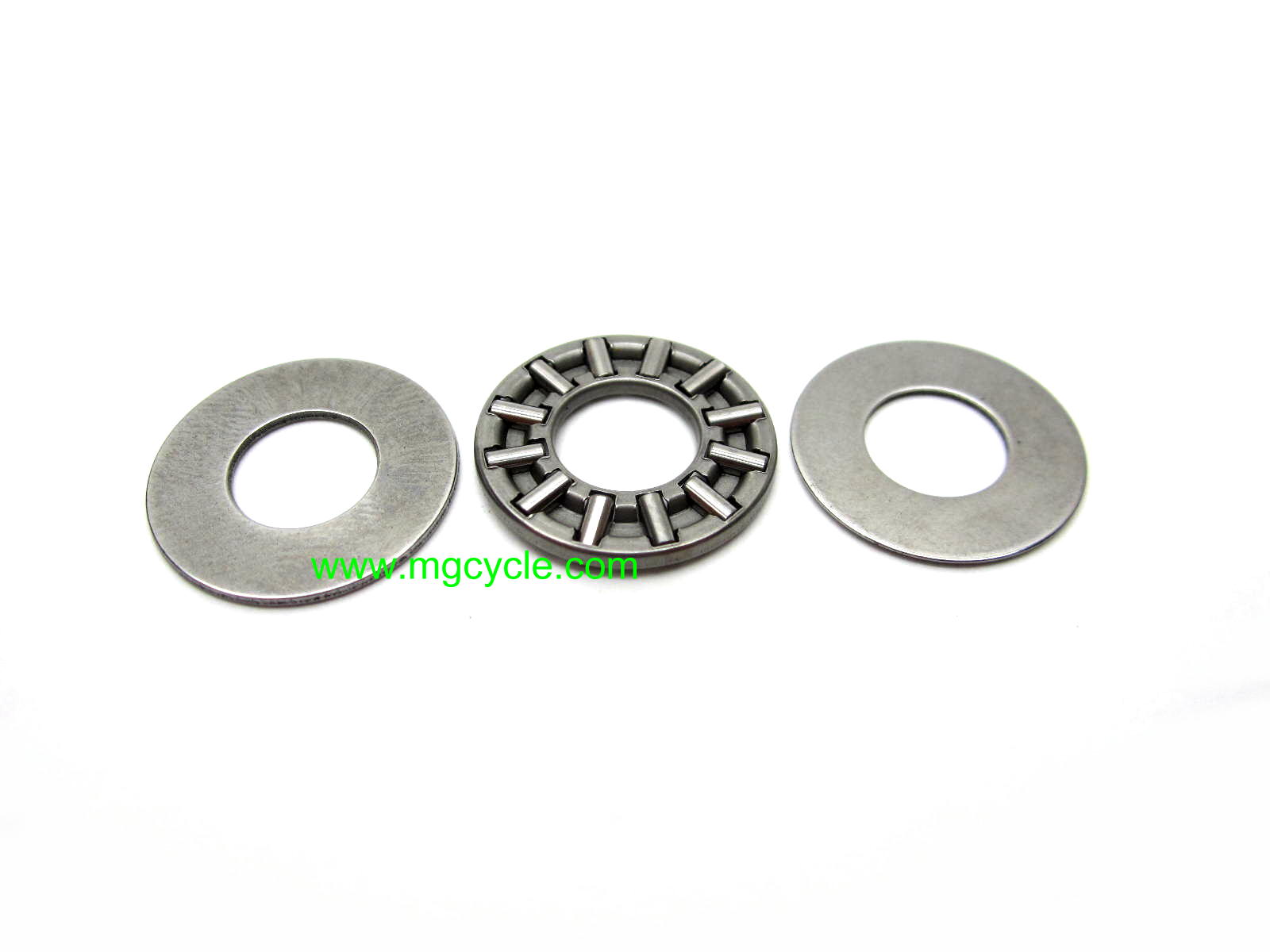

gstallons Posted July 26, 2017 Posted July 26, 2017 I hope the washer in the upper right is going to go on the worn portion of the part on the lower left ? If not & If this is as ugly in person as in the picture , you are spinning your wheels and you need this part also . That bearing is a Torrington bearing and most good bearing supply stores can get you the OEM quality part . I'm not too sure about this replacement in the picture.
docc Posted July 27, 2017 Author Posted July 27, 2017 No, the throw out bearing and face washers have no wear, that's just the impressions from the gear oil.
gstallons Posted July 27, 2017 Posted July 27, 2017 The part on the lower left , is the thrust face in perfect condition ? Can you clean it up and take a close-up photo of it ?
docc Posted July 27, 2017 Author Posted July 27, 2017 Yeah, actually they look pretty peckered up and pitted. Under 7x magnification, some of the rollers show light pitting and wear also. The replacement thrust bearing (right) is caged on one side. Not sure which direction it installs.
docc Posted July 27, 2017 Author Posted July 27, 2017 I looked at MGCycle and the same half-caged bearing with the small rollers is pictured. I wonder which way to face it? I'm inclined to put the closed cage back away from the gearoil. 1
