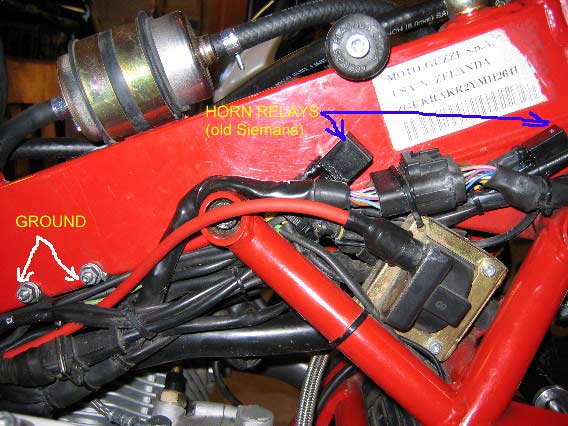

Bill Hagan Posted January 26, 2004 Posted January 26, 2004 Just finished wiring in a pair of the Siemen's relays for the Fiamms. Mounted the relays in tandem along the right side of the frame roouting the stockhorn wires carefully over to them. Wired 14 guage from the battery trough a fuse holder with a cap on it. Use heat shrink and zip ties all along the existing wiring harness. Made up two separate harnesses with a ground (from the right side fuel pump bolts) and the hot from each relay down to the horns (again, heatshrink , zip ties and dielectric grease).**** Can you post or email a pic or two of your setup, docc? I have those horns, but, before installing, ordered Hellas from Griots only to find they are platter-size.
docc Posted January 26, 2004 Posted January 26, 2004 I'll have to wait until the tank is off to photo the relays. I mounted them along side the right of the spine. The stock horn wires reach them without modification. The 12V hot comes from the junction block after the stack of terminals began to eat into my psyche.

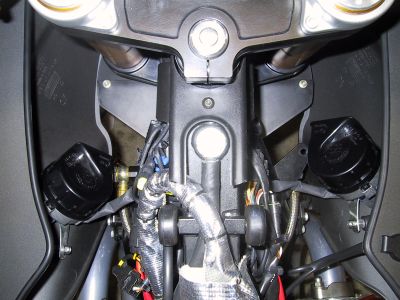

al_roethlisberger Posted January 26, 2004 Posted January 26, 2004 Looks good Here is my horn relocation for the LeMans: http://www.v11lemans.com/forums/index.php?...c=1499&hl=horns ...it really cleans up the front
jrt Posted January 26, 2004 Posted January 26, 2004 Al, maybe it's just the angle, but it looks like your horns are pointed into the fairing and most of the noise would be directed back at you. Wouldn't that just counteract having loud horns? J
al_roethlisberger Posted January 26, 2004 Posted January 26, 2004 Well, because of the mounting location I chose, the angle of the horns as shown are pretty much the only choice in regard to "fit"... clearing the subframe, steering damper(missing/removed in the photo), fuel tank, etc... That being said, no, they are "loud as hell" Oh sure, I can hear them from the "drivers seat", but there's no trouble hearing them outside the bike.... about 1000x louder than the stockers(OK, that's an exaggeration ... but many times louder for sure ) ...and they're "stealth" al

docc Posted February 2, 2004 Posted February 2, 2004 Can you post a pic or two of your setup, docc? Bill, Here's a shot of the relays zip-tied to the right side of the spine. The stock horn wires will reach them there and they are grounded to the mount for the fuel pump using star washers. The relays are the old Siemans that came out of the bike when the Bosch went in. I'm theorizing they'll be OK since each is only carrying 3 amps and they are only activated when the horns are on. Still , I elected for a redundant back-up circuit by using a separate relay for each horn. EDIT, November 2006: One of the horns started blowing poorly. I swapped out the Seimens for the Bosch relays and all is well. I'm using GEI for the bikes main relays now. EDIT, September 2009: The bike's main relays have moved on to sealed OMRON while the Bosch relays (one for each horn) continue to blow FIAMMS though a 10 amp fuse.
