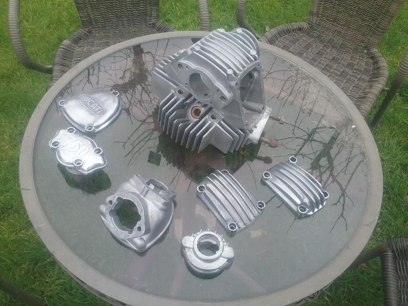

68C Posted March 28, 2021 Author Posted March 28, 2021 On 3/26/2021 at 1:22 PM, Tinus89 said: Lovely story. Can we ask for pictures? Expand These are the casting that make up just one cylinder head. I think there are twenty castings all told and about the same number of ball bearings, the only plain bearings being on the gear selector mechanism and kick start shaft. Makes the V11 rather simple. 4
