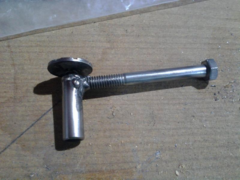

68C Posted February 12, 2018 Posted February 12, 2018 Going back to Doc's original post in this thread; no you probably do not get a true reading with worn tappet arms but will most likely be within acceptable tolerance. If you are really keen use the old technique whereby you determine the adjuster thread pitch, screw the adjuster in to zero clearance then back of to set the gap. If you have a 1mm thread pitch it is easy as 1/2 turn equals 1/2mm (0.5mm). Helps if you keep the jam nut fairly snug while adjusting so clearance does not change as you tighten it. Years ago I saw a tool sold for this purpose with a round scale marked off in tenths, similar to a car cylinder head bolt torque indicater. We are only trying to adjust the clearance not strip and machine arms or adding super duper roller arms. How about this sort of tool? Or this gnarly kind. . 1
docc Posted February 12, 2018 Author Posted February 12, 2018 Oh! That's brilliant! I have one of those clever valve adjusting tools! I can set my valves as usual, then use the "thread measure" to see any difference, That would be the rocker wear! Brilliant! [so, does anyone have a rocker adjuster handy to measure the thread pitch? Or know it, offhand?]
