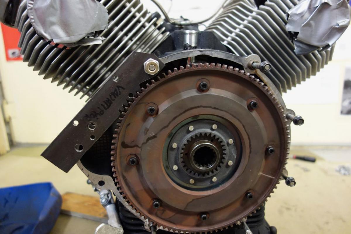

slowkitty Posted May 15, 2018 Author Posted May 15, 2018 Dear all, I am really at my wits' end here. Removed the gearbox and the springs all seemed to be properly seated. I even replaced the friction plates with the "thinner" 7.5mm ones from MG Cycles, no luck. There is no complete neutral when the clutch lever is pulled in, such that I can rotate the rear wheel freely. Some pics are attached. Can anyone tell if the flywheel is from a 5-speed or 6-speed? Does it even matter? Took out the pushrod to make sure that I am not missing any washers etc. What I will do now is to measure the length of the pushrod actuated extension when the clutch lever is pulled in against the compression of the springs in a vice. This is to see if there is a possibility that the pushrod was not being actuated sufficiently to compress the springs and disengage the friction plates. Am I correct to say that the pushrod is in contact with the pressure plate "bowl" by the fact that there is tension in the clutch lever? Thanks for the views, guys, keep the advice coming. Andy

docc Posted May 15, 2018 Posted May 15, 2018 Thinking back, I recall that both the gearbox input hub and the engagement of the pushrod differs between the single plate (Scura) clutch and the twin plate. Which input hub are you using with the new twin-plate clutch?
slowkitty Posted May 15, 2018 Author Posted May 15, 2018 Thinking back, I recall that both the gearbox input hub and the engagement of the pushrod differs between the single plate (Scura) clutch and the twin plate. Which input hub are you using with the new twin-plate clutch? Hi, I am using this now ... https://www.gutsibits.co.uk/pr/TheShop/index.php?f=e&Shnew=1&Model=1&ModelName=1100%20Sport%20V11&Cat=CLA&CatName=Clutch&spPage=1#topbar You are right, the Scura's stock hub is lower (in thickness) than this hub cos it need only engage one friction disc than twin. How does the engagement of the push rod differ? Andy
docc Posted May 15, 2018 Posted May 15, 2018 It is the tip, as I recall. Where it engages the "cup." From the link above: "I did get the end of the clutch push rod machined down at a local shop and everything engaged as it should."
docc Posted May 15, 2018 Posted May 15, 2018 Could this be the issue? https://www.v11lemans.com/forums/index.php?showtopic=19621&p=218722
slowkitty Posted May 15, 2018 Author Posted May 15, 2018 It is the tip, as I recall. Where it engages the "cup." From the link above: "I did get the end of the clutch push rod machined down at a local shop and everything engaged as it should." Hi, Docc, I saw that. It did not make sense to me cos the V11Rosso is a twin-plater in the first place? This from the parts catalogue: In any case,it seemed that in that post, the owner reduced the length of the rod than lengthened it. Andy
slowkitty Posted May 15, 2018 Author Posted May 15, 2018 Could this be the issue? https://www.v11lemans.com/forums/index.php?showtopic=19621&p=218722 Dear Docc In that link, the context of that discussion was on the installation of a RAM "5-speed unit in a V11 if they have the correct transmission input hub." Thanks for the input (no pun intended .. LOL). The mystery thickens. I may well remove the flywheel and start all over again. Sigh. Andy
docc Posted May 15, 2018 Posted May 15, 2018 To clarify, you have replaced a twin-plate clutch (two friction plates, a steel intermediate plate, steel flywheel, and "push-button")? The push rod and input hub are held over from the Scura single-plater?
