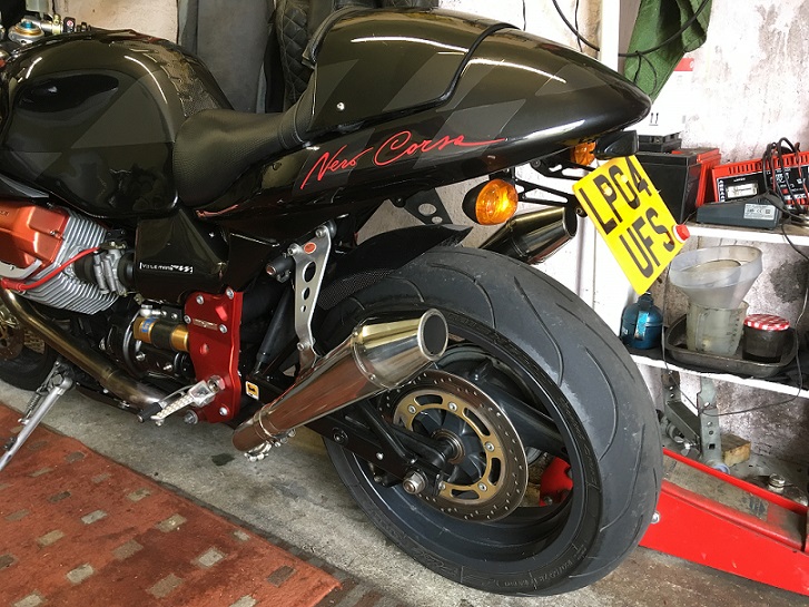

Steve S Posted June 4, 2018 Posted June 4, 2018 Here's another option, get a pair of link pipes made and then you can fit any cans that you want

footgoose Posted July 2, 2018 Posted July 2, 2018 IMG_0688.JPG Here's another option, get a pair of link pipes made and then you can fit any cans that you want yup, great idea. those hanger brackets look easy to make and unlimited positioning options
Steve S Posted July 2, 2018 Posted July 2, 2018 IMG_0688.JPG Here's another option, get a pair of link pipes made and then you can fit any cans that you want yup, great idea. those hanger brackets look easy to make and unlimited positioning options The hanger brackets are aftermarket Ducati ones the bolt holes happen to be in the same place as the V11
