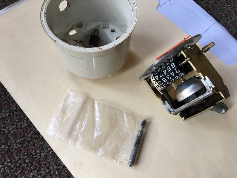

I took my ITI speedo off a couple of years ago. There was some attempt at getting a gear made but nothing came of it. Tomorrow I'll see what's in the box & let you know.

That looks useful and I think the odometer and trip meter gears are there, so I could use it to see about getting some made.
Can I buy it from you?

Dragging this up from the past, if anyone gets here looking for answers, the gear that sits on the worm drive, and also the connecting gear up to the odometer are identical in the Ducati ST2/ST4/900SS CEV speedo.
The face looks like this:
The trip button is also the same, so it's a good source of 3 spare parts!
Good to know! Do you suppose the entire unit might swap out"?
Sadly the body is 85mm, so the entire thing would not.
The internals are pretty much identical, bu the dial is bigger, if the dial could be turned down to 80mm then I believe the whole mechanism would fit into the ITI plastic case. The dials are not interchangeable because of where 0mph sits.
Here is a pic to show the Ducati gear you installed,  the state of the old one, and the Ducati odo/trip gear and reset.
