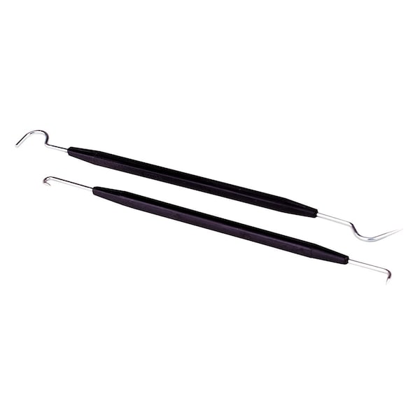

gstallons Posted April 8, 2021 Posted April 8, 2021 Uhhh , you have about $100 worth of picks and use caution & hope for the best ! Worst of all , make sure not to gouge the bore of the fork tube . 1 1
docc Posted April 8, 2021 Posted April 8, 2021 5 minutes ago, gstallons said: The OTC 7103 set is probably the best to use . Ok, gotta get me some o'them. I have a selection of dental picks, but they are very hard and rather brittle. 1
