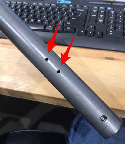

Drewteague Posted October 6, 2018 Posted October 6, 2018 Hey, everyone! I'm a tech doing a light track day build on a customer's '99 V11 Sport. He complained of no compression damping in the front. I dismantled the left fork, and found nothing excessively worn or broken. I did notice, however, that the cylinder of the cartridge is drilled three times. This allows all the oil to puke out the sides, eliminating most of the damping until the ring passes the last hole, about 3/4 of the way through the entire stroke. This corresponds to the reaction I get from the fork leg compressing it manually, off-bike. Everything I've found indicates that this is the stock setup, and that it hasn't been mangled by someone in a past life. Now, Has anyone plugged or filled any or all of these holes in order to increase overall damping, directing more or all of the oil through the adjustable valve, thereby increasing the range of adjustability? I'd definitely be running 5w if I ended up modding it in this fashion.

Drewteague Posted October 9, 2018 Author Posted October 9, 2018 Awesome info, everyone! Thanks for all the links. Good to know my intuition was on point. My customer lent his bike to a friend who claimed it suddenly lost damping, but it seems it was always like that. I'll confer once again with the bike owner to clarify his goal (eg. more damping altogether, more progressive damping, etc) to make a plan around hole location/size and fork oil weight. I'll post the results when I have them. 1
GuzziMoto Posted October 9, 2018 Posted October 9, 2018 On 10/9/2018 at 3:54 PM, Drewteague said: Awesome info, everyone! Thanks for all the links. Good to know my intuition was on point. My customer lent his bike to a friend who claimed it suddenly lost damping, but it seems it was always like that. I'll confer once again with the bike owner to clarify his goal (eg. more damping altogether, more progressive damping, etc) to make a plan around hole location/size and fork oil weight. I'll post the results when I have them. Sorry I missed this. I was on vacation in Moab. The forks on my wifes V11 seemed OK. But I had them apart to do some servicing, I decided to put them together without the springs to feel what the dampening curve felt like. What I found was that there was zero compression dampening until the forks were near bottom. It was because of the holes in the tube, they let oil flow freely until the pistion was past the holes. It was only at that point that the oil was forced to flow through either the piston valving or the adjuster. This meant that the adjuster only could affect the bottoming of the fork. The rest of the travel the adjuster did nothing. As I understand it there are more than one version of Marzocchi forks on the various V11 models, along with Ohlins. I don't know how the later V11 forks are, but the wifes early red frame V11 forks had no compression dampening until I blocked off one of the two holes on the compression side fork leg. Sadly it has been a few years, so I don't remember the details. But as I recall hers had two holes and I blocked off one of them. I also changed oil viscosity. I found that when I was forcing the oil to flow through the valving I actually needed thinner oil. I think you will be happy with the results. I know my wife is.

Drewteague Posted October 10, 2018 Author Posted October 10, 2018 Success! The damping is much better, and the adjuster screw has a greater effect on the range. I used 5w, but in the future, the fork could easily be tuned with a more viscous oil to suit different conditions. I made a modification gallery with some pics: https://www.v11lemans.com/forums/index.php?app=gallery&album=268 2
