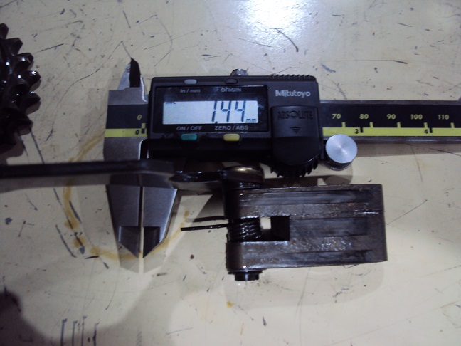

Lucky Phil Posted December 6, 2018 Author Posted December 6, 2018 It’s super rare for the Sport to pop or hiccup anymore. If it does, it is typically in high ambient temperatures at low rpm (stuck in summer traffic.) How did your tensioner and chain look upon removal? They looked fine to me @ 42,000 klm docc but more Guzzi experienced people might want to comment, Pete? Tensioner wear between .98 and 1.44mm, drive teeth looked perfect. Ciao 1
