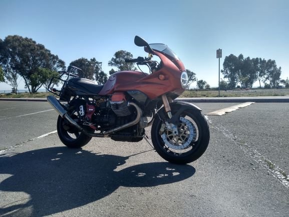

Kuni0 Posted June 14, 2019 Author Posted June 14, 2019 Update to this old thread. My Rosso Corsa is almost all together now. Engine wise, i went with a megacycle 620x9 camshaft, installed a roper plate, and simply cleaned the piston and cylinder heads and valves (as well as lapping them). Upon inspection of the intake, it seems that someone had done some porting and polishing in a previous life. I've put everything together now basically after much trial and error. Ran into a few issues (stator wires broke apart so I re-soldered it together) and general difficulties of getting the bike together by yourself, but finally it started yesterday! After chasing down an issue that turned out to be a loose ground wire behind the transmission, she started right up! God I miss that sound! But.... now the clutch doesn't seem to "engage". The clutch lever has no pressure to it, and it doesn't sound like it's engaging at all when the bike is on. The master cylinder was disconnected from the clutch line while I was working on it, but I've bled the entire line through and still no pressure. From what I've read, it seems possible the the clutch pushrod is actually fully engaged and that's why the lever has no pressure to it. Any thoughts or ideas to try? I'd really like to not drop the motor again if possible to remedy this. I was thinking about opening up the transmission side case (have to anyway) and seeing if I can move the pushrod from there or not. One of the three screws on the slave cylinder is horribly stripped, so taking that off would be a big PITA. Any thoughts are appreciated!

Kuni0 Posted October 15, 2019 Author Posted October 15, 2019 Thanks ScuRoo for the message, thought it would be nice to give an update from my project Everything is back together, and the bike (seems) to be running great. It turns out it was the pushrod button that had fallen out causing me to not have a clutch. As I mentioned in my post, the heads seem to have been ported in a previous life so I didn't need to do that. All of the modifications and work that's been done to my Le Mans are: Megacycle 620x9 cam, Roper plate, cleaned the carbon buildup on the pistons/ head and valves (and re-lapped them), ported heads (don't know who though), new rings and gaskets, K&N pods, Mistral headers and crossover, and Staintune exhausts from a Guzzi Daytona. I kept the original valves, springs and pushrods, though I would like to find some chrome-moly pushrods at some point. The ECU is stock to my knowledge. It did have a dyno-jet, but I took it off as the engine fumbled between 1.5-3.5k RPM, though I may but it back on and play around at some point. My goal from the beginning was to give the motor a refresh and add a little more power without sacrificing reliability. I seem to have done that; it pulls harder and faster then before and is intoxicating to accelerate out of a corner. I haven't had it on a dyno, don't know who (if anyone) in the Bay area has a motorcycle dyno. I've only put about 1000 miles on since the rebuild so long term reliability will remain to be seen, though I think issues might be due to my own meddling rather then something wrong with the parts/ modifications. I'm very glad it's so easy to work on the Guzzi! For the most part, a decent mechanics tool set can get most of the bike apart, and parts (including the specialty tools) are surprisingly available online. I would just add, make sure ALL bolts are properly tightened! I've run into so many issues with loose/ loosing bolts because I was so exited to have the bike running again. 1 1

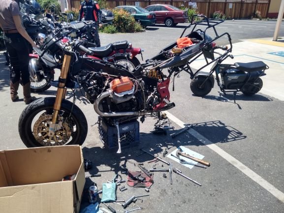

Kuni0 Posted October 15, 2019 Author Posted October 15, 2019 Didn't exactly use the right tools all the time, but you use what you got 1 2
