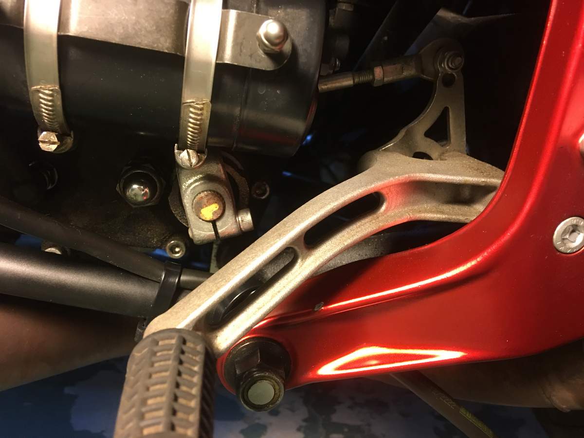

antmanbee Posted February 7, 2019 Author Share Posted February 7, 2019 Here is a picture of the shifter. Looks pretty parallel to me. There is a little nick in the paint on the pork chop, but if that was the problem wouldn't that only affect down shifting and first gear? I have a problem up shifting except for second. Link to comment Share on other sites More sharing options...
docc Posted February 7, 2019 Share Posted February 7, 2019 The connections ("pawls") look splayed to me, buddy. Shortening the connector shaft may be worthwhile. This would be a good starting point, to fully fettle and tune this shift mechanism. Totally worth the effort before cracking into the gearbox, itself. Cycle it while looking for binding points. It is a mess of a thing with lots of potential binding points. Link to comment Share on other sites More sharing options...
antmanbee Posted February 7, 2019 Author Share Posted February 7, 2019 If I shorten the connector shaft it will make it more likely for the shifter to hit the pork chop. If I move the arm on the trans one tooth clockwise first then I could shorten the connector shaft and slightly lift the shifter arm so it would not contact the pork chop. Link to comment Share on other sites More sharing options...
docc Posted February 7, 2019 Share Posted February 7, 2019 If I shorten the connector shaft it will make it more likely for the shifter to hit the pork chop. If I move the arm on the trans one tooth clockwise first then I could shorten the connector shaft and slightly lift the shifter arm so it would not contact the pork chop. Yeah, bud. There ya go. Consider removing the pivot bolt and servicing the whole shebang. you've got this! Link to comment Share on other sites More sharing options...
