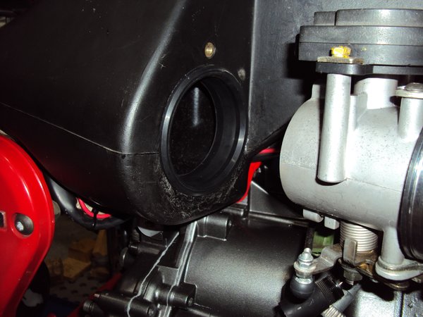

po18guy Posted January 15, 2020 Posted January 15, 2020 Oddly (maybe not), my airbox lid has no recycling symbol on it. Perhaps even more strange is that it carries the 'e11' mark, which seems to be the UK certification of motor vehicle safety and environmental acceptability, issued to the UK by the EU authorities. The part itself appears to be 'blow molded', in that the outer dimensions are controlled and texturized by the mold, while the material thickness fluctuates somewhat and interior dimensions are smooth and less consistent. Such a manufacturing process tends to favor a thermoplastic - but in recent decades, many new and hybrid types of plastic have entered the market. So, back to the start: who knows? Acerbis may not even remember... As well, the box itself may consist of an entirely different material, formed differently. :shrug:
Lucky Phil Posted January 15, 2020 Author Posted January 15, 2020 11 minutes ago, po18guy said: Oddly (maybe not), my airbox lid has no recycling symbol on it. Perhaps even more strange is that it carries the 'e11' mark, which seems to be the UK certification of motor vehicle safety and environmental acceptability, issued to the UK by the EU authorities. The part itself appears to be 'blow molded', in that the outer dimensions are controlled and texturized by the mold, while the material thickness fluctuates somewhat and interior dimensions are smooth and less consistent. Such a manufacturing process tends to favor a thermoplastic - but in recent decades, many new and hybrid types of plastic have entered the market. So, back to the start: who knows? Acerbis may not even remember... As well, the box itself may consist of an entirely different material, formed differently. :shrug: Acerbis got back to me and said to contact Guzzi as it was made to their specs. Should have realised that would;d be the case. Anyway its sorted now with a strong and decent result by lets call it airless plastic brazing. Polyethylene rods used as a hot glue. Not welded but closer to brazed. Ciao 4
po18guy Posted January 15, 2020 Posted January 15, 2020 Nice work - proving that perseverance pays off. We apparently love these bikes inasmuch as nothing is simple. Maybe a plug change and air in the tires. Outside of that, we repeat or invent Italian curses and/or become impromptu Guzzi engineers (and darned good ones at that!). 1
Chuck Posted January 15, 2020 Posted January 15, 2020 Attaboy. The material looks like glass filled polypropylene that we used to mold high strength parts out of at GM. When making prototypes, I used much the same process. I had a big hunker soldering iron that would make (sort of) a bead that I filled with the same material.
Lucky Phil Posted January 15, 2020 Author Posted January 15, 2020 8 hours ago, Chuck said: Attaboy. The material looks like glass filled polypropylene that we used to mold high strength parts out of at GM. When making prototypes, I used much the same process. I had a big hunker soldering iron that would make (sort of) a bead that I filled with the same material. Ok Chuck interesting. No fibres here though. The airbox material is quite strange in that it doesnt actually melt so you cant melt the base material and combine it with a filler rod like welding you need to abandon trying to melt the base material and use the filler rod like bronze welding or brazing or soldering. If you put a hot iron against it it will eventually produce a black liquid which at first I thought was melted material but when it dried it was rock hard brittle. I think it was just oils being excreted under high heat. If you hit it with a heat gun on full temp it just goes all rubbery but wont actually melt, but it does float in water. I'm still thinking its a cross linked Polyethylene but for anyone wanting to join it the method I have used seems really sound. BTW docc I think the inlet trumpets will be the same material, I have an old butchered one I'll material test when I get a chance. I've done hours of reading on plastic in the last week and its a very complex and involved topic. Pretty soon most of an internal combustion engine will be made from it with lots of serious research being done on using it for crankshafts,engine blocks,rods and even exhaust systems. Weight reduction being the primary aim. presently intake manifolds,rocker covers,cooling system fittings and oil pans are the major components usually made from a nylon base material but within 10 years it seems most of the engine will be plastic. My wife now understands why I'm lying awake at 3am most nights Ciao 1 1
Lucky Phil Posted January 16, 2020 Author Posted January 16, 2020 I'm calling the airbox done.The modified area could be better aesthetically but this plastic is almost impossible to finish nicely. I might make some little 1/4 moon 1mm thick ally plates to cover the modified area painted black and attached by some small PK screws to make it look nicer but once the side covers go on I doubt you'll notice the area. Ciao 3

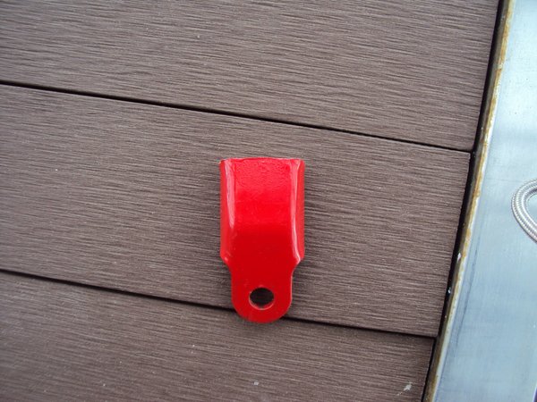

Lucky Phil Posted January 23, 2020 Author Posted January 23, 2020 So I got tired of trying to find a paint match for the Greenie frame. Did a lot of research mainly historical here and on the interweb and anything that was suggested as really good wasnt available here so I went bugger it and got 500ml of 2 pack matched. My r/h pork chop was faded and polishing it didnt help so I thought now was the time to address it. The main frame isnt too bad and I need to paint the front frame support where I removed the horn and regulator bracket as well. Here's the result from an automotive paint supply places special machine. The top 10mm where my fingerprint is (doh) is the new paint. Good enough for me. I asked if he could cross reference what the machine came up with to a code or particular car model with the same shade. Unfortunately not. With the piece in your hand its only the surface finish due to my fingerprint that gives it away, the colour is as close to perfect as you'll get. BTW the guy didnt tell me about the wet area just handed it back to me with the tin of paint. Must be some old paint guys party trick:) Ciao 1 2

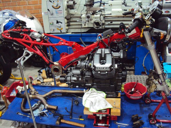

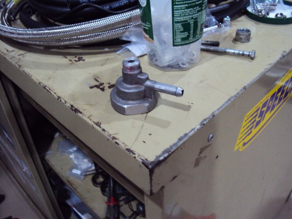

Lucky Phil Posted February 2, 2020 Author Posted February 2, 2020 Looks like a step backwards. Side plates and front support removed for painting and finish removal of the remains of the old horn/regulator bracket. I have also machined the threaded section of the regulator housing back 5mm and relieved the body to give me some comfort factor clearance wise to the TPS. The Centauro throttle cable arrived and am glad to say it fitted perfectly. Ciao 3
docc Posted February 3, 2020 Posted February 3, 2020 So, this step has always destroyed my ability to perform the kind of amazing project this is. At some point, the progression has to be completely disassembled and refitted. That, IMHO, is one of the hallmarks of true Professionalism. One that will always reveal me as a mere hobbiest. Welldone, LuckyPhil. (And once again, thanks for the generous sharing of the methods, process, and progress . . . )
