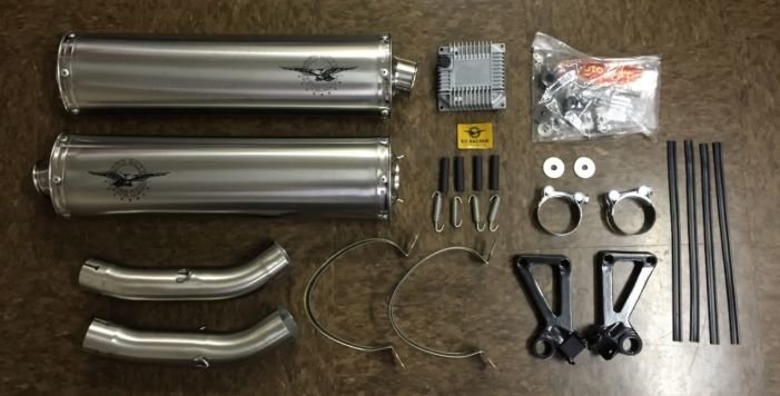

MartyNZ Posted April 8, 2020 Posted April 8, 2020 4 hours ago, Lucky Phil said: I dont know what muffler hangers he's used but I wouldn't mind knowing as I quite like the higher mounting. I think the Daytona hangars, and the V11 titanium kit hangars, are shorter than the standard V11 hangars. https://www.v11lemans.com/forums/index.php?/topic/19278-hi-ti/&tab=comments#comment-207822
Tomchri Posted April 8, 2020 Posted April 8, 2020 4 hours ago, MartyNZ said: I think the Daytona hangars, and the V11 titanium kit hangars, are shorter than the standard V11 hangars. https://www.v11lemans.com/forums/index.php?/topic/19278-hi-ti/&tab=comments#comment-207822 And the Sport 1100 hangers, pricey but available . Cheers tom.

footgoose Posted April 8, 2020 Posted April 8, 2020 yes. the high mount hangers from the V11 Ti kit ARE the very ones used on the early Sport 1100. I purchased the latter some years ago and have compared them to the ones from the Ti kit.
Chuck Posted April 9, 2020 Posted April 9, 2020 2 hours ago, footgoose said: yes. the high mount hangers from the V11 Ti kit ARE the very ones used on the early Sport 1100. I purchased the latter some years ago and have compared them to the ones from the Ti kit. As if Guzzi would tool up to make something new.. 1
Lucky Phil Posted April 9, 2020 Author Posted April 9, 2020 2 hours ago, footgoose said: yes. the high mount hangers from the V11 Ti kit ARE the very ones used on the early Sport 1100. I purchased the latter some years ago and have compared them to the ones from the Ti kit. Ok cool thanks. I have some high mount brackets in the workshop I bought years ago but from memory the location mounts are wrong. I must dig them out and check what they are and why they dont work. Ciao
footgoose Posted April 9, 2020 Posted April 9, 2020 ah yes, there is a plate with the Ti kit that does relocate the mount holes. I will dig that out. Gimme a minute
Lucky Phil Posted April 9, 2020 Author Posted April 9, 2020 38 minutes ago, footgoose said: ah yes, there is a plate with the Ti kit that does relocate the mount holes. I will dig that out. Gimme a minute Damn this is embarrassing. I dug out my hangers that I've had for years and there is adaptor plates there. I've been collecting parts for this for so long I've forgotten what I actually have. Sorry for wasting your time. 2
Lucky Phil Posted April 9, 2020 Author Posted April 9, 2020 Well I tried the hangers and adaptor plates and they dont work with my mufflers. The plates move the hangers outboard about 6 mm and the the hanger mount area interferes with the seat cowl. I could relieve the inside of the cowl 3mm or so but when I loosely hung them in place the high rise didnt look good with my slender mufflers. I have never really liked the high pipe look of the Ti cans to be honest but it seemed to look good with the big bulky std cans. Maybe its the angle of the image or something dont know but the high hangers with my mufflers is not the look for me. I had the feeling of deja vu during the the whole process actually:) Ciao
