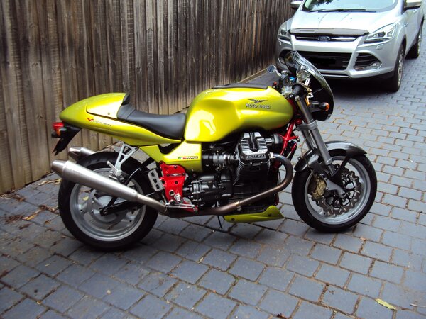

Lucky Phil Posted May 12, 2020 Author Posted May 12, 2020 Well here it is out and about today. First ride.I started off trying a std V11 map. Strangely my bike has a very early 1.5M ecu and for some reason doesn't present any baro pressure info. Paul Minnaert seems to recall the early version ecus have something different about their baro sensor. He's going to get back to me when he has access to his info.Hopefully this just means for the moment the baro pressure is set to a default. The other odd thing about my ecu is it's loaded with a 2002 LeMans map. I've owned this bike for 10 years so pre Guzzidiag days so how this has gotten in there I dont know. Any thoughts anyone? Maybe this is why the baro info isnt displayed because that function of the early ecu isnt compatible with the later maps. Hopefully Paul can shed some light. I reset the CO trim to Zero from -12 and the bike seemed to idle fine on the V11 map. Starting's a bit ropey though. So out I went for a ride around the block. It didnt run that well to be honest, I mean it got me around the block a few times but you wouldn't go out for a ride like that. It did allow me to check the oil pressure though with the temp oil pressure gauge though with the oil a bit warmer and 60 psi @ 2500 rpm at around 52 deg C oil temp on 15W-40 which will be adequate. I believe that figure will turn out to be the relief valve setting. If I feel the need for more pressure I'll go to a 10W-50 but I'm OK with 60psi max. I came back and decided to load the map Gritman had sent me for his V11/Daytona and see what that was like. Out I went and it was way better, not really great but you could go for a ride at a pinch with this map although truthfully it will need to be a lot better than this. Gritmans bike has pod filters and I'm not sure what crossover so it was never going to be perfect. The gearbox shifted nicely and the bike went well in all other areas so now its just about the tuning. Hopefully I'll be able to get some help with that. Now Then. How it was when I bought it 10 years ago Ciao 9
Admin Jaap Posted May 12, 2020 Posted May 12, 2020 Well done! And looking great too! FWIW, when I did this conversion I had it on the dyno and had my ECU flashed by a specialist. Best € 400,- I've ever spent. After that it went line the proverbial freight train.
Lucky Phil Posted May 12, 2020 Author Posted May 12, 2020 10 hours ago, Admin Jaap said: Well done! And looking great too! FWIW, when I did this conversion I had it on the dyno and had my ECU flashed by a specialist. Best € 400,- I've ever spent. After that it went line the proverbial freight train. Thanks Jaap, yes the plan is to get it running acceptably well to ride it round and put around 1000 klms on it and then do the dyno tuning. What ecu did you run? Ciao
