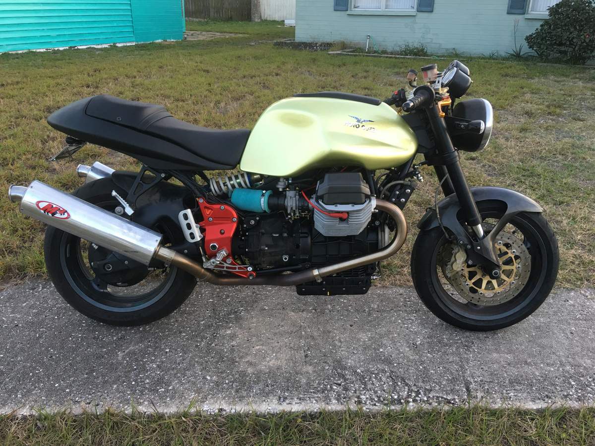

antmanbee Posted February 17, 2019 Author Posted February 17, 2019 I have done a complete tune. Set to meinhofs .157V and valves adjusted to raceco specs air bleeds all the way in and throttle bodies balanced at idle and 3000RPM. BPR6ES plugs. CO trim at -10 but I am going to set to 0 tomorrow morning before my ride. Bike starts and runs fine. Sounds awesome. I don't know if it pings or not yet as I have not ridden it much yet. I will find out tomorrow. I was just curious what others experience was with their bikes. I am just looking to get a general idea for the V11. It seems to vary considerably from model to model as to what octane it likes. I see no reason to use premium if it not needed. I have M4 pipes and foam filters with stock intake tubes and no air box. (See photo)

antmanbee Posted February 21, 2019 Author Posted February 21, 2019 Everything stock here, except for the map. Custom map, flashed the original ecu. It took 11 dyno runs to get it perfect. No pinging anymore. Better mileage, better running, more power. Well after about 300 miles this past weekend split between two days I have some observations. I have been getting the dreaded coughing in the intake at lower RPMs (around 3000) under light throttle. It was much worse the second day when it was quite hot out, about 90F. I had reset the CO trim to 0 before the rides. All balanced perfectly at idle and 3500. I may need to try a different map or tweak the original. mg77, what was changed in your map to correct your issues? I have attache a pic of my crossover. I think it's a stucchi. I run pods and M4 pipes. My plugs look fine. My gas mileage was about 40mpg. My other issue is vibration. I get a buzziness in the bars. My other Tonti bikes are much smoother. This bike has the original flywheel/clutch assembly from the old engine on a new to me engine, but all the marks are lined up on assembly. I was concerned about this as I was unsure how these engines are balanced at the factory. Are they balanced with the flywheel attached or only the crank and the other associated rotating mass, rods, pistons, etc. I know many here install other flywheels and don't seem to have issues. What else to look for?
