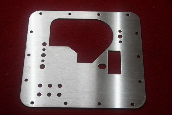

swooshdave Posted February 22, 2019 Posted February 22, 2019 From what I can tell the original Roper Plates are no longer available. The last batch that was offered via Scud appear to be sold out. It looks like you can get a similar item from Gutsibits which seems to be an unauthorized copy (it's not like this was patented) and we might debate the ethicality of that... https://www.gutsibits.co.uk/pr/TheShop/index.php?f=d&Model=&q=ENA00004 At this point it looks like the Gutsibits version is the only option available. Two questions: What are the advantages and disadvantages of the the aluminum vs stainless steel versions? Why wasn't stainless steel used on the original version? Was it because at the time CNC aluminum was more readily available? I would think these days that laser or water cut stainless steel would be less expensive, and perhaps the material less expensive too? Are there any issues caused by the thickness of the aluminum plate? Would @Pete Roper be amenable to an authorized run of stainless steel versions if we could source a manufacturer? It seemed to work with the shift springs. Thoughts?

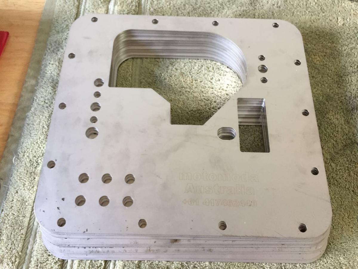

pete roper Posted February 23, 2019 Posted February 23, 2019 I've just had another run of plates done. Only got five done this time but I can up the number if required. Yes, the doppelgänger plate is an exact copy of my design and was stolen without my consent by the thieves at Gutzibits or whatever they call themselves. As I've said before, if they'd just asked me I would of said add £5 to the cost of each one and send it as a donation to Medicienes sans frontiers and it would all of been good. As it is they can go and roger themselves with a rusty star-picket. Oh, and sorry to anyone who tried to contact me about the plates. As mentioned in another thread a lot happened last year which meant I was a bit 'Under the pump', most of my work is with 8V CARC bikes nowadays and I simply didn't have the time or inclination to get more plates made. Now Michael is out of hospital and back at work, as long as my health holds together, I would be able to run up batches as required. 2

pete roper Posted February 23, 2019 Posted February 23, 2019 This week we've got a Cafe Sport in and I'm going to introduce Michael to the wonders of V11's. Damn nice bike, it's that that prompted the new run of plates as it hasn't got one. The reason I stay with the 2mm plate is I'm a bit worried about vibration causing cracking if I go much thinner. I might just be being paranoid though...... Pete

pete roper Posted February 23, 2019 Posted February 23, 2019 Stainless steel and yes they are heavy, but they won't crack and fall apart! They're going in a Guzzi fer Christ's sakes a few extra ounces isn't really an issue! 2
