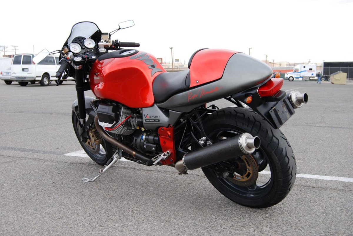

Now, those bars you have on "Hi Ho Silver", are they the OEM clipons?
The early Sports clipped on below the top triple with a riser. Perhaps an homage to the 70s V7 Sport's delicious "Goosenecks" . . .
If those are 54mm at the clamping surface, they are exactly what I am looking for. Also appears that they accept standard 7/8" bars?
