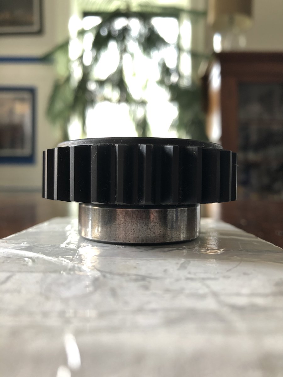

sp838 Posted May 4, 2019 Author Posted May 4, 2019 Just received what very well might be the world's last NOS 6 speed single clutch disc hub... Fingers crossed for the rest! 1
docc Posted May 4, 2019 Posted May 4, 2019 That, right there, is the most hen's teeth ever seen in one spot at one time . . . 1 1
