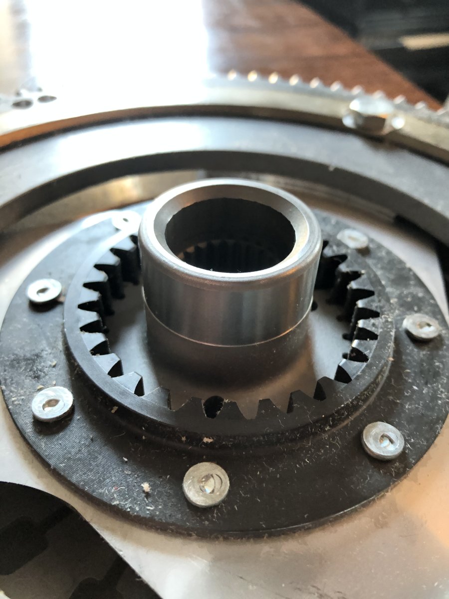

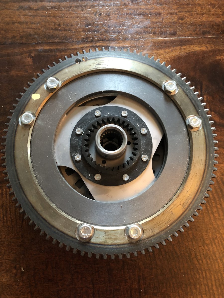

Clutch received today, and I'm already wracked with doubts wondering if I made a terrible (ie costly) mistake in buying it. I guess worst case is I return it and have to eat the costs of shipping both ways.
Below are some photos, if anyone more knowledgeable and smarter than I am (so basically all of you guys) can tell from the photos if this will work or not, or what I should do to check, I would be very appreciative.
For starters, where is the much discussed hub supposed to go? I doesn't fit over the small cylindrical thing in the assembly, though the teeth look like they would match... Does that cylindrical thing get replaced by my hub? If so how do I remove it? I tugged on it and it won't come out on its own. (Maybe I need a hammer) Should I disassemble the whole stack?
Next thing I have doubts about are the outer teeth which I assume are for the starter motor. Anyway, please weigh in and let me know on a relative scale just how much of a mistake I made and how big an idiot I am... Happy to take more photos if that helps.
view into the place where I think the hub should go:
does this guy come out?
new hub looks like it wants to go in here but does't fit over that part. Splines on the inside of it don't match anyway:
this friggin guy:
Just knock out the supplied hub and use your 6 speed one. You might need to turn the fitted one to get the splines to line up if the're out and then pull/tap it out from the engine side. Looks to me like they have just slid it in there for packaging and transport purposes.
Ciao
Right. The "hub" fastens to the gearbox input shaft with a special nut and "safety retention washer" with a tab that turns down to lock the "slotted nut."  Don't let it walk off and end up like po'-po' me . . . :blink:
  • Thanks 1
That's what I was hoping you would say...
What about the big starter motor gear? Should I count the teeth/measure diameter? Or that one of those things that is common to Guzzi across models and decades?
Will get a new hub nut and washer when install time comes 🤞🤞
Got the included hub out, single plate V11 hub fits like a glove. And yes, the hammer was necessary. large.3F7E0AD0-D823-4AFB-9AD7-4F462EB46BD4.jpeg

Yep thats what I meant you to do. Why have you removed the ring gear bolts? You could even use your original gearbox input hub if its not worn.
BTW the image of the gearbox input hub ring nut in doccs post is shown fitted the wrong way around. The tapered face goes towards the gearbox side.
