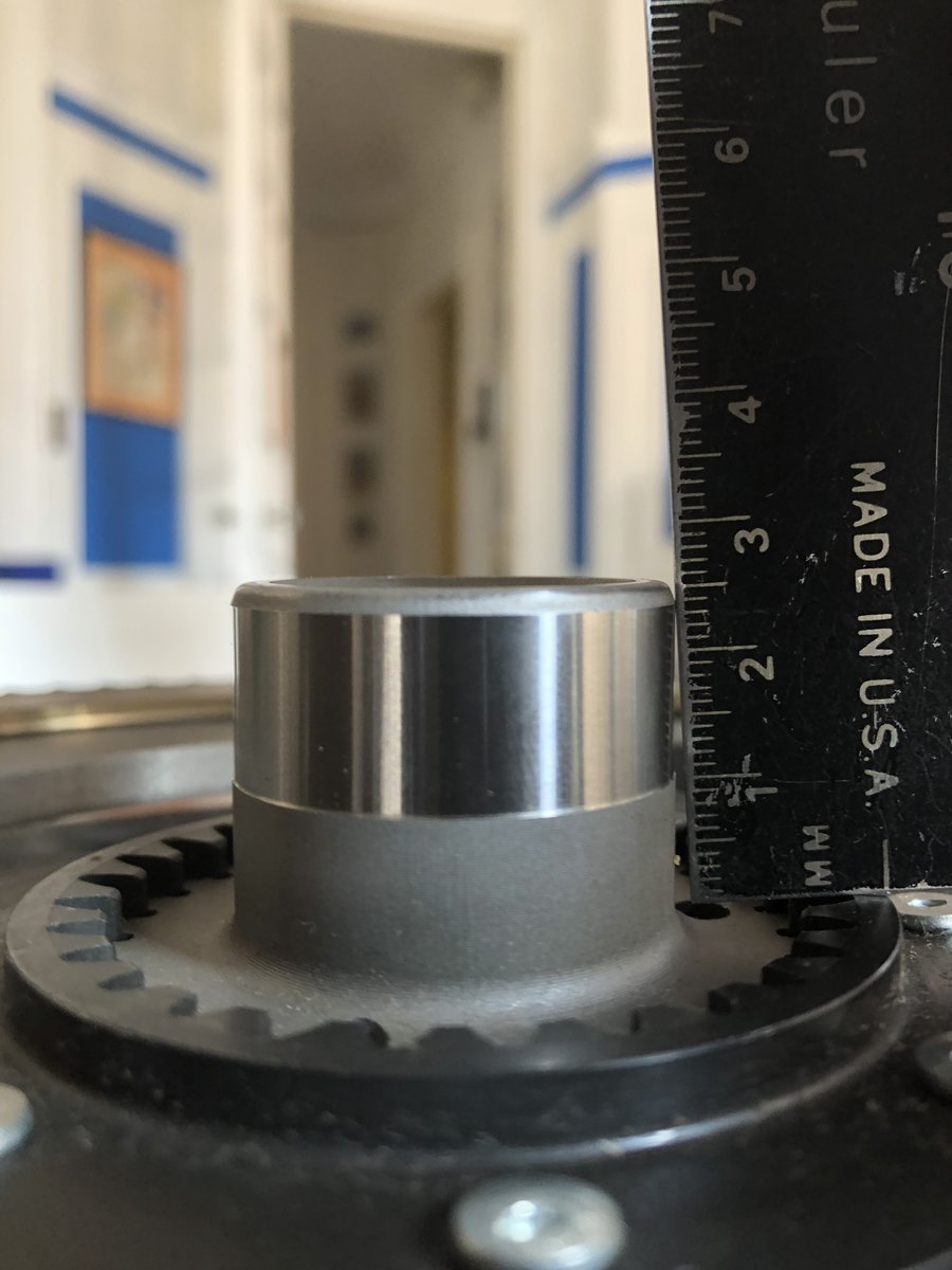

So after days of staring at these parts, I have a fresh round of concerns. I'm hoping maybe someone has some clutch parts laying around that might help shed some light on them one way or another. Looking at the hub provided with the kit compared to the hub for our bikes, the one from the kit has a much longer collar for attaching to the gearbox primary shaft. The gear is also about 1mm taller:
Hub included with kit protrudes about 20mm from the total height of the clutch:
The hub for our bikes barely clears the height of the clutch stack if at all:
The top of the drive splines sits about 6mm below the top of the clutch:
So my question is, does the primary gear shaft in our bikes protrude from the case enough to make up this difference?
Now I am also wondering also if the total height of this clutch matches the height of the stock clutch in my bike. Here is the total height, it's roughly 55-56mm:
If anyone still has their old stock single plate clutch laying around, or even a double plate would be useful too, I'd love to know how they compare to these measurements, most importantly what the stack height is.
And the protrusion of the primary gear shaft is also a huge concern... Thanks guys. Would obviously be great to have this all figured out before I open the bike up which is why I'm being so needy... I'd be fine with just calling it off and returning these parts if that what the conclusion is.

yikes, looking at these photos doesn't make me feel very good about the amount of protrusion of the primary gear shaft, and the clearance of the case behind it... :unsure:

dunno, did he? I'd feel a lot more confident about trying it if I had a better understanding of the dimensions of all these parts. Looking at the photos you posted from inside the clutch housing, it looks like things are very close on the gearbox side.
