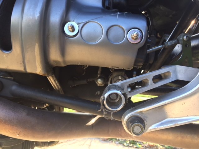

czakky Posted April 23, 2019 Posted April 23, 2019 Check that your linkage is correct. I can post a pic of mine in a few minutes. 1 1

czakky Posted April 24, 2019 Posted April 24, 2019 Might be hard to see with the starter in the way but if you’re way off you’ll know 1
ready180a Posted April 24, 2019 Author Posted April 24, 2019 4 hours ago, czakky said: Might be hard to see with the starter in the way but if you’re way off you’ll know Hi thanks for the heads up and photo my adjuster rod looks to be adjusted longer than yours in the picture Have you Changed yours ? Tony

czakky Posted April 24, 2019 Posted April 24, 2019 4 hours ago, ready180a said: Hi thanks for the heads up and photo my adjuster rod looks to be adjusted longer than yours in the picture Have you Changed yours ? Tony I’m sure mines been adjusted. 1
GuzziMoto Posted April 24, 2019 Posted April 24, 2019 Before you blame the insides of the transmission I would make sure the external linkage isn't binding on anything. The distance the lever moves to change gears is not the same between all the gears, it seems to have to move farther as you go to higher gears. This can cause an issue with the linkage binding that was not there when shifting between the lower gears. KISS. Check the simple stuff first. 1
