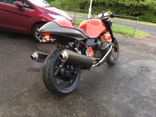

ready180a Posted May 30, 2019 Author Posted May 30, 2019 Just a quick update the gear box is now sorted after sourcing a new old stock recall kit from America. The ones fitted from Moto guzzi where 2 mm to thick not slowing the gears to be Selected a massive thank you for everybody’s input on trying to find the problem . The bikes all back together and hoping to get an mot . Regards Tony 2
