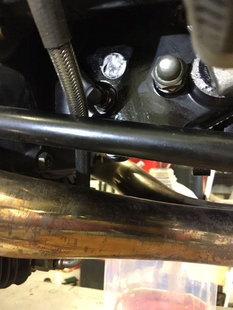

sp838 Posted July 9, 2019 Posted July 9, 2019 So, lately while riding my neutral light has been blinking out, flickering, displaying weakly, then coming back full brightness, then going out again, without any apparent reason. Wiggling the gear lever sometimes brings it back, sometimes doesn't. Then it comes back again on its own. This is annoying, but I have a good feel for the bike's shifting so not really a big deal, I can find neutral without it. Figured I'd eventually get in there and figure it out when I had a moment. Today I thought I'd take a look down there, not to take anything apart but just take a peek to see if there was anything visibly wrong, like the connector being loose. Lo and behold, there is a good amount of oil weeping out of the hole right above it, where it seems like one of the selector wheels is housed on the other side. Didn't have time to do anything about it, just snapped a photo and muttered some curses. Anyone else had this problem? Any ideas what it might be? Mine is an early 01 model. I redid the selector assembly with the updated spring first thing when I bought the bike about six years ago...
andy york Posted July 9, 2019 Posted July 9, 2019 you can search around here for fixes. Several different ways to go about it. Something about a dime being the perfect fit. I cleaned mine up, made sure it was dry and the glued the dime in there with gasket sealant .....same thing you used on the cover after your spring upgrade andy 2

luhbo Posted July 9, 2019 Posted July 9, 2019 This axle is loose, so you'd better fix it, do not just close this hole. It's basically the same procedure as for the spring. Cover off, lower wheel off, axle out, clean shaft and hole. Then apply strong Loctite and put the axle back into its seat, wait half an hour, reassemble the rest and put the cover back on the housing. Don't forget to change the neutral switch. 1 2
Lucky Phil Posted July 9, 2019 Posted July 9, 2019 7 minutes ago, luhbo said: This axle is loose, so you'd better fix it, do not just close this hole. It's basically the same procedure as for the spring. Cover off, lower wheel off, axle out, clean shaft and hole. Then apply strong Loctite and put the axle back into its seat, wait half an hour, reassemble the rest and put the cover back on the housing. Don't forget to change the neutral switch. +1 Ciao
andy york Posted July 10, 2019 Posted July 10, 2019 1 hour ago, luhbo said: This axle is loose, so you'd better fix it, do not just close this hole. It's basically the same procedure as for the spring. Cover off, lower wheel off, axle out, clean shaft and hole. Then apply strong Loctite and put the axle back into its seat, wait half an hour, reassemble the rest and put the cover back on the housing. Don't forget to change the neutral switch. or you can do this again. 1

Tinus89 Posted July 11, 2019 Posted July 11, 2019 I've had this as well, the press-fit axle changed into a loose fit, causing the axle/shaft to rotate and leak oil. I've fixed it two years ago by extensively degreasing it and then glued it into place using a commercial two-component epoxy-based metal glue. Tried it before with liquid gasket sealant, did not hold as the shaft experiences some degree of torque when shifting, so the sealang broke again.
