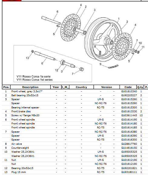

footgoose Posted July 17, 2019 Posted July 17, 2019 I'm finally getting around to installing the Ohlins from my '03 Rosso Corsa parts bike, on to my '02 LeMans. Searching through the digital manuals I have loaded, I can't find any information supplement covering Ohlins. The shock and forks were rebuilt at Ducati Indy, and set to factory specs, tho I'd want to do the next rebuild myself. Tree p/n's are the same. I'd like to know what's different from standard regarding parts, (I see the axles are a different length) torques, and general assembly requirements, install wheels, etc. Is there a Ohlins manual supplement out there anyone knows of? Parts diagram? I think I've heard that the '03 and up are a different batch/model from the original ones on Scura. ? If there's a discussion somewhere on the forum, I can't locate it. The RC owner manual only says "Hello, yes you have Ohlins" It's all together, and a straight forward job, but I want to be confident.. and right. 1
Lucky Phil Posted July 17, 2019 Posted July 17, 2019 On 7/17/2019 at 12:28 AM, footgoose said: I'm finally getting around to installing the Ohlins from my '03 Rosso Corsa parts bike, on to my '02 LeMans. Searching through the digital manuals I have loaded, I can't find any information supplement covering Ohlins. The shock and forks were rebuilt at Ducati Indy, and set to factory specs, tho I'd want to do the next rebuild myself. Tree p/n's are the same. I'd like to know what's different from standard regarding parts, (I see the axles are a different length) torques, and general assembly requirements, install wheels, etc. Is there a Ohlins manual supplement out there anyone knows of? Parts diagram? I think I've heard that the '03 and up are a different batch/model from the original ones on Scura. ? If there's a discussion somewhere on the forum, I can't locate it. The RC owner manual only says "Hello, yes you have Ohlins" It's all together, and a straight forward job, but I want to be confident.. and right. Expand The Ohlins stuff is covered in the V11 workshop manual update. I can email it to you if you want. Ciao 1
Admin Jaap Posted July 17, 2019 Posted July 17, 2019 FWIW: I upgraded my '01 V11 Le Mans to Öhlins. Easy. Fits w/o adapting. Only thing that didn't fit anymore was the front mudguard and the front axle. I went for an early Aprilia RSV CF one and a Ducati 999 hollow front axle. 2

footgoose Posted July 18, 2019 Author Posted July 18, 2019 my front wheel isn't exactly centered. I am using the wrong spacer and I can't find the correct one from the Rosso Corsa. On this list #7 is the one I'm after, but which? there are 3 The 390 is for std Lemans -Sport (from my 02) and p/n is correct for 02. the 380 is for RC and NC - T6 the 300 is for RC - T5 So, how to determine which is mine... T5 or T6 my guess is T5 as it's earlier, and Nero Corsa came in 04? ( nope, NC was an o3 too) thoughts?
