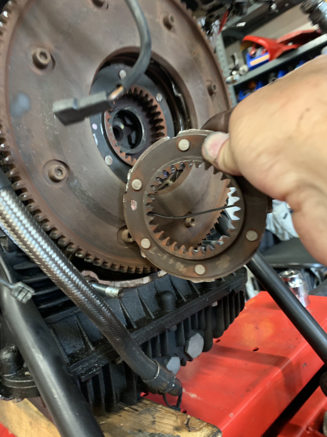

Dadparent Posted July 18, 2019 Posted July 18, 2019 I already had 2 V11 lemans 2002 resp 2004 with the same clutchproblem. Both slipped and both had very sticky stuff inside the splines of the clutch It looks like a mixture of clutch residue and oil. But the crankcase/clutch environment had a greasy face but not full with oil. So I don’t think it is the cranckcaseseale. But the question is “ what else can it be?” Verzonden vanaf mijn iPhone met Tapatalk Pro

Dadparent Posted July 19, 2019 Author Posted July 19, 2019 Thank you all very much for the involved answers This must be helpful to find the definitive solution. . Now it is something like this. By the way one disk was completely ruined. The Hart was taken out. Interested in pictures of that? And is there a clutch wich is the best? I now ordered by Stein Dinse (gu) 200033302 . The gu is for the original Guzzi number. Dinse don’t use that. Verzonden vanaf mijn iPad met Tapatalk Pro
luhbo Posted July 19, 2019 Posted July 19, 2019 Oil will get inside the clutch only through a loose input hub in combination with a worn or otherwise damaged O-ring on the input shaft (or inside the hub, as you like it). What you have here can also be the result of someone having greased the splines, hoping to reduce wear on them. You should find only red rusty dust inside the clutch, and more or less worn splines.
Dadparent Posted July 19, 2019 Author Posted July 19, 2019 Here is one more. I will take off the flywheel after this weekend and send a picture of that areaVerzonden vanaf mijn iPad met Tapatalk Pro 1 1
